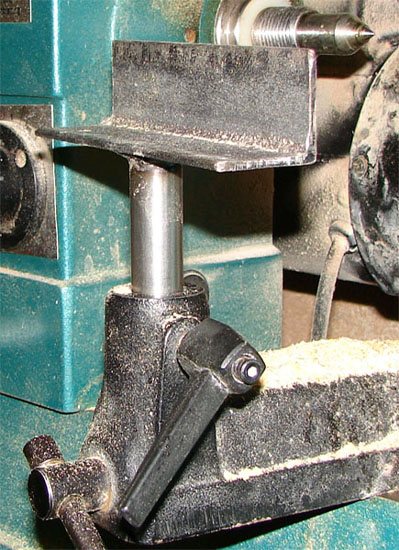

Similar questions come up pretty often. A new, or custom, tool rest can be made by your local welder at very nominal cost. I get mine for $10.00 each. That's the shop minimum. If I got several at one time the per rest cost would be less. Below is my pen and small projects rest.
<br />
