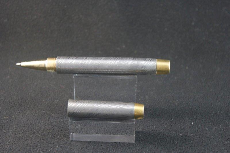

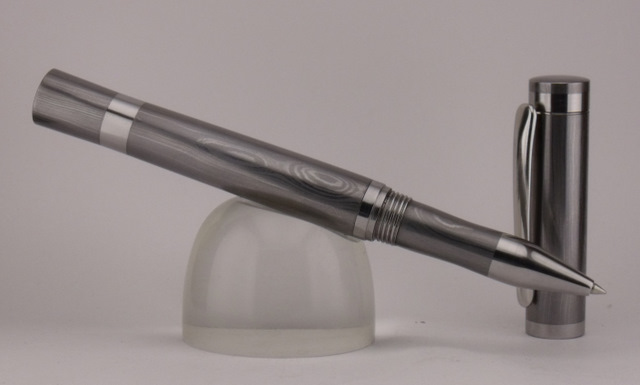

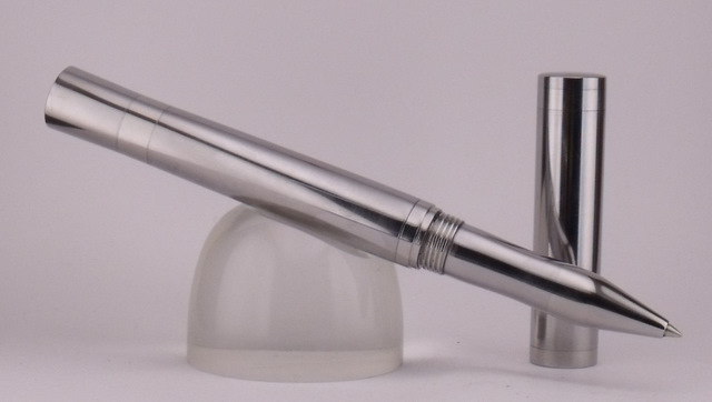

Here is a damascus pen a made a while ago.
The first pic is of it 'polished' which as you can see, hides the damascus pattern. The second pic is after I soaked it in ethanoic acid ( vinegar ) to bring out the grain. I do use it now and then ( on my desk at home ) and have found that just handling it, stops it from rusting.

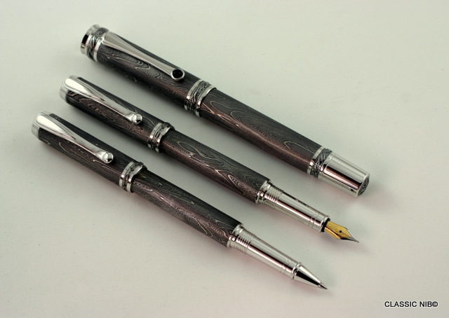

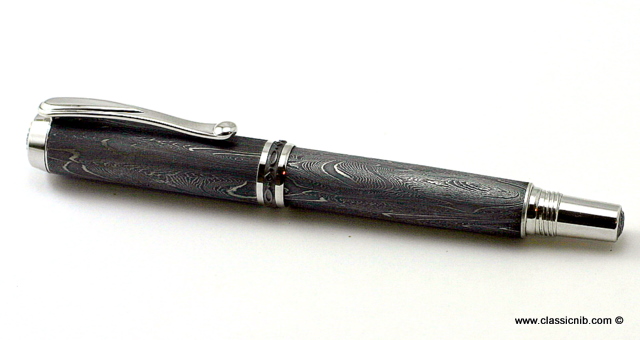

here is a photo of one of mine I made:
and three more that I've sold:

I'm not sure I understand Roy. :confused: The etching has already brought out the pattern. Are you saying that oiling it after etching will increase the contrast even more so?
I hope it does, because I find the pattern ( in mine )too subtle as it is and would prefer if it stood out more.
Skippy, oiling with not deepen the etch only acid will but it will bring out the contrast. Be sure to use a non fibrious cloth to oil the barrels as a fibrious cloth will leven lint on the damascus, I place a small drop on my finger and rub in until it feels almost dry, this way the oil gets into the layers that were etched. Also instead of vinager which works use an etching solution sold at here in the states at Radio shack to etch printed curcut boards called Ferric Chloride, it will give deeper etching faster.

Skiprat; What a difference !!! If you had not stated what you did to inhance the grain, I would have taken the first photo as chrome, stainless, or aluminum. The folding of damascus realy gives it a super look. As for the rusting, I have Japaneese irons in some of my antique hand planes that are hundreds of years old that are damascus steel. They turn a dark gray or black, but I have never seen rust on any of them. My guess would be that the makers quenched them in oil as they worked the metal, and retained some of that oil in the metal itself. A lot of the plane irons and swords were forged out of old boat anchor chains that had been in the elements for a number of years with no rust. The color in Roy's pen, is what my plane irons look like after 200 years. I have never reoiled my irons or sword blades. Jim S
Jim, most of todays Damascus is high carbon and in certain conditions will surface rust, I think it was the Jr. Statesman F/P in the photo of the three pens is the one I noticed that had surface rust when I got back from a show in Houston, after a lite coast of gun oil the rust stopped and no more rusr has ever appeared as far as I know as I sold it and the new owner has bought an other from me six months later.
