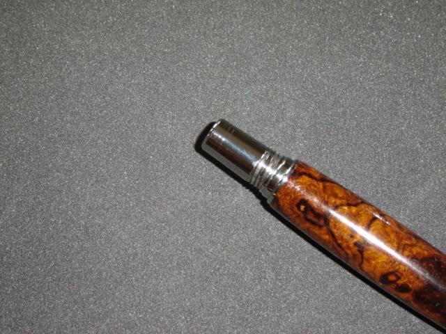

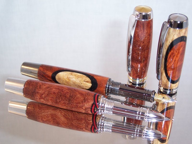

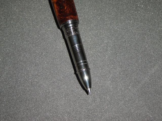

I'll start. Below are two Jr Gents, I didn't think the segmented pen was fit for sale so it became mine, the other was a pen I received in a pen swap last summer. When I leave the house both of these pens are in my pocket and have been for almost a year now. When they are not in my pocket they are on my desk being used... everyday.
The fountain pen must have been opened and closed a thousand times and the rollerball just about as much and neither show any wear let alone any damage.
The Jr Gent is one of my best sellers and I have never had a complaint from any customers or friends that I have given them to but have received several repeat orders so some people are having good luck with them!
A picture is worth a thousand words so here are my Jr Gent "daily users"

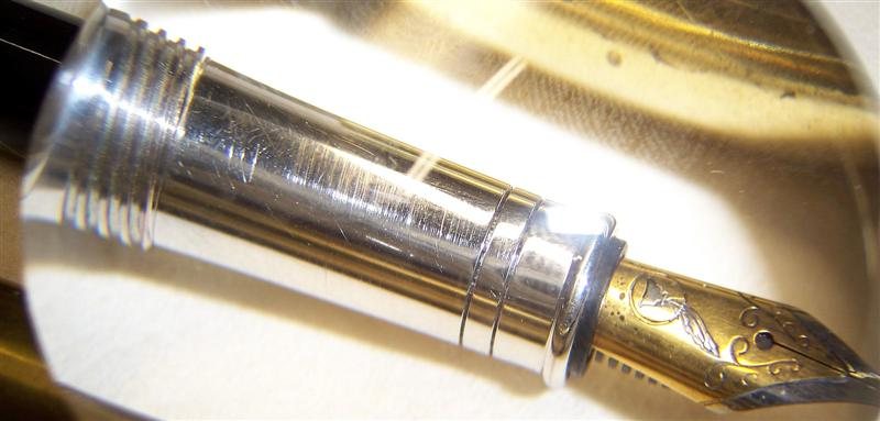

Ok this is the pen l have talking about after my last posting l decided too pull the pen apart and try too figure out what's going l also took these photos to show, it is clear to me now this pen has some real problems, the center threads are showing plating problems l had missed seeing that as l was more concerned about the grip.
John, we'll get to the bottom of this yet!:)
The plot thickens....

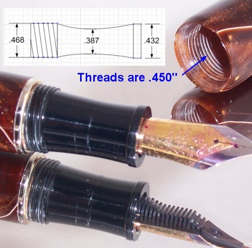

I'm writing with my home made fountain pen this morning when I noticed something so decided to post my thoughts.
The more I think about this problem, the less I think it's a manufacturing fault and more a users fault. The photo below is a "home built". It uses a nib from a Ligero kit and the cap is all acrylic. While the nib isn't metal, it does show similar circular scratch patterns as some of the photos shown in this and another thread.
What is interesting are the dimensions of the nib and cap. You will note that the cap threads are .450" dia. and the rest of the cap is 7/16" or .437" and all smooth plastic, nothing else is in there to cause scratching. That leaves plenty of clearance for the nib to enter the cap without anything cutting anything. Please note the curved shape of the nib, the center area where the scratchs occur is .387 diameter.
How does the cap leave these marks when the threads are .450 dia and the center of the nib is .387 AND it's the narrowest part of the nib. If the threads were doing this, you would think the widest part of the nib would be damaged but it's not, only the center, narrow section.
As stated earlier, I don't have the answer, but I sure as heck would rather find out what's causing this rather than jumping on the forum saying Craft Supply sucks and has bad pens or plating problems and will their warranty cover this type of damage. That thinking gets us nowhere and I think we should shift from blame and focus on solving the problem, after all, we are a bunch of sharp pen makers right?
Here is my pen, look at the dimensions then look at the similar scratch marks and think about what you see and lets come up with some thoughts as to what is causing this. By the way, this was one of my junkers, is only a few months old and was put in a pen rack and rotated with my other fountain pens so hasn't seen that much use so I was surprised to see the marks.

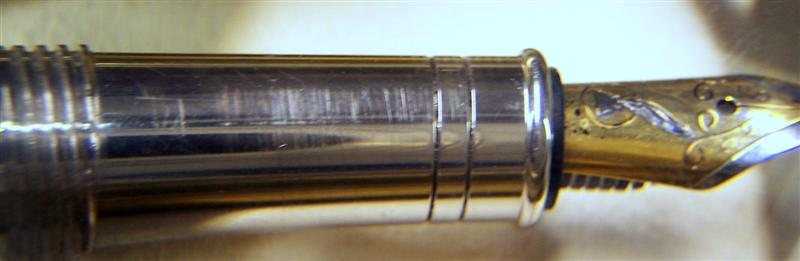

I have had this for about 6 months. I noticed the markings within the first month of use,I checked inside the cap to see if it had loose threadings or if there were small pieces of metel but saw nothing. I am very careful when handling my pen this is my show piece(one of Rodneys DI burl)It was put together very carefully(Expensive blank) and is still in very good condition other than the marking at the ends. I guess that plastic may cause scratches on Titanium but Im no expert. Everybody is entitled to there own opinion. I love CSUSA Jr. kits but dont like the looks of a Cigar.....

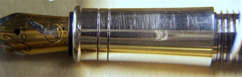

I have an El Grande that was toast anyway, so taking George's pics as my target, I set out to scratch the section. Now, keep in mind the El Grande section is black plastic, not metal. I was able to scratch the narrowest part of the section by turning the cap, as if I was engaging the threads, but holding the cap a bit cockeyed. That way, the pen threads touched the section, and since they were at a pretty steep angle, and they were turning, they produced pretty strong scratches. FWIW
I agree with Grant's assessment. I believe that these scratches are caused by user error. The user is clearly tilting the cap as he is placing it on or removing it, causing it to scratch the finish. This could happen with any screw-cap pen from any manufacturer.
