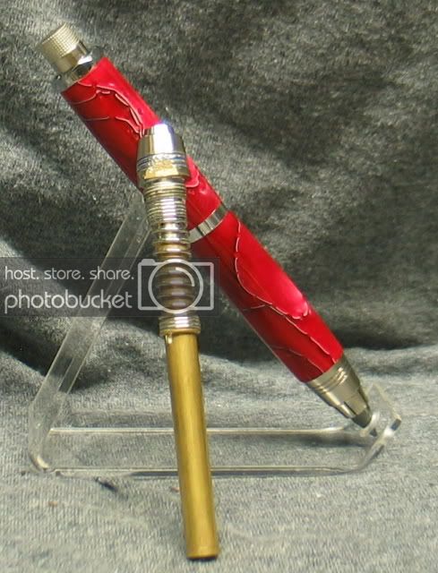

To make sure we're talking about the same pencil...this is the 5.6mm pencil I do and the "sacrificed" fixture with the flats is shown. Poor man's tap and tube holder for painting, too.
