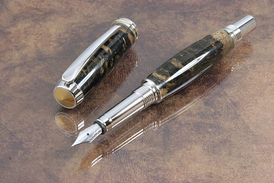

CA finish is not my forte especially in Ebony. Every time I make a pen I keep on trying the finish.
I can't tell you how happy I'm with this one. I feel as excited as when I turned my first pen with friction finish multilied times 2.
Which background you think is best for this pen. I like the darker one, it shows the colors of the pen and contrast better I think.

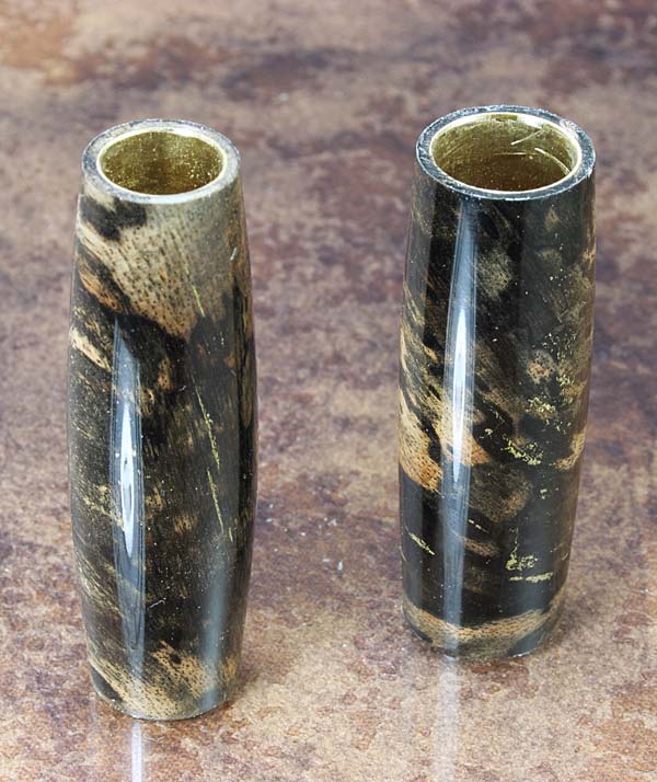

Just in case I mess up the pen while assembling I made sure I took a pic of the blanks.

Fantastic Pen. I really like that material, as well, and of course, your finish is great.

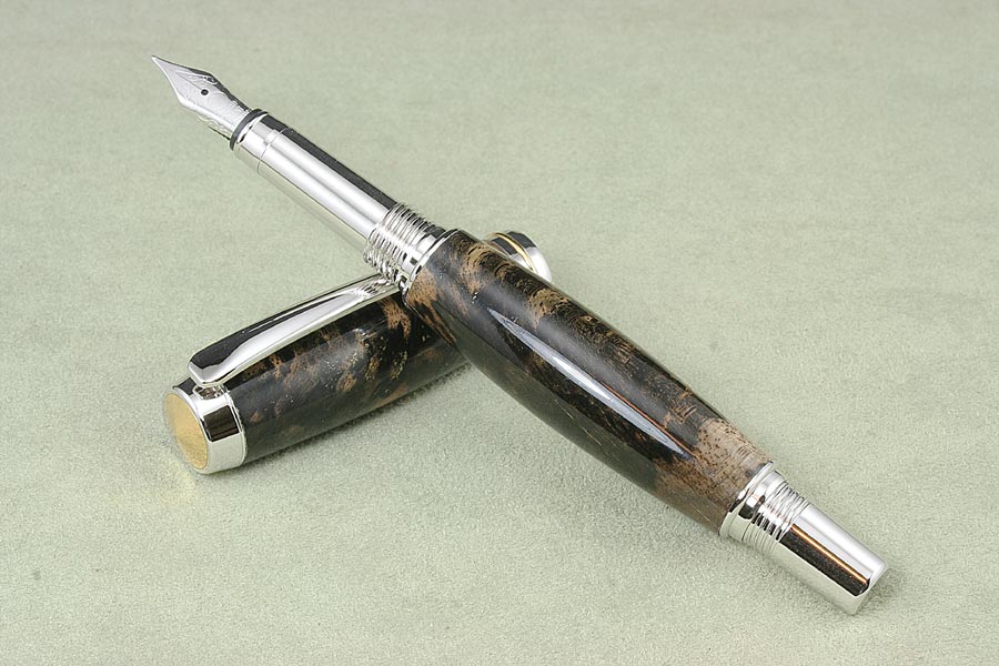

Very nice pen. Very shiny finish! [:)] But in contrast to others, I prefer the lighter background. Maybe a darker background without patterning in it would be good, but especially on the third picture down, the pen really seems to blend into the background for me. The brown is too close in color to the black of the pen, and the pen has a similar mottled sort of pattern as the background.
One question- I guess I'm not seeing an inlay part of the pen- what part is that?

Very nice finish. If all of your pens come out like this one, you might need to diffuse your lights to keep the reflection down. Nice looking pen.

It looks to me as if there are some small areas of metallic dust fill in the area of the clip. Though it might look different in person, I would tend to prefer fill in with sanding dust or just CA for depth.
Not trying to be a nit-picker, Alex. It is a beautiful piece of work.

Angboy the metal I used is brass, it seems to blend pretty good with the pen and the cracks and voids on the pen were not to big. The first picture where the tubes appear shows a bit more I guess. Off course in person is a lot easier to see them.
