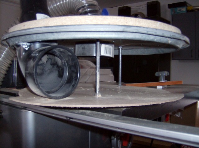

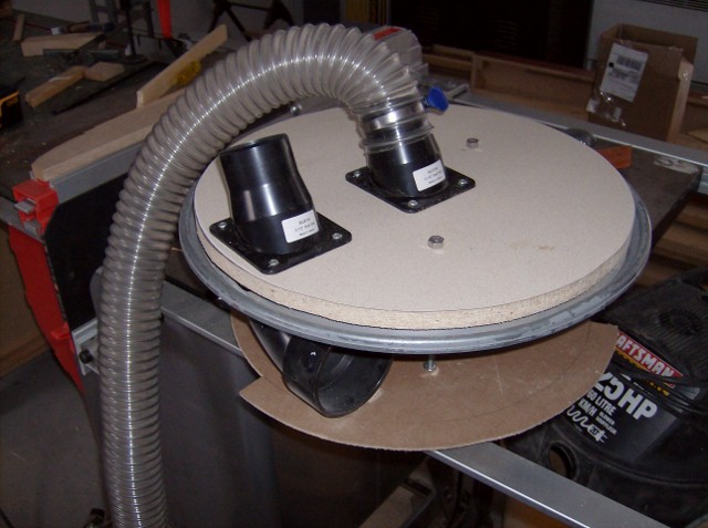

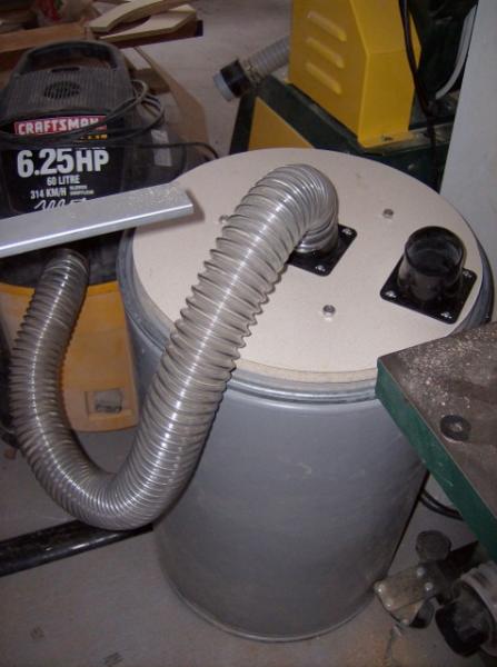

I built one myself and connected it to my shop vac. It was a quick satuday project. I should have spent more time getting the shape and diameter to fit perfectly in the can. Even though it is not a perfect fit, after 2 weeks of use, I filled the can and only a 1/2 cup of very fine dust got through to the vaccum.

That it can. I made mine in an afternoon for my shop vac. Then when I finally got a DC, I re-worked the Thein separator to fit my DC (took it apart, recut the holes to larger size, replaced all the fittings with larger fittings to fit the DC, replaced the three stand-off bolts between the lid and the baffle with longer sections of all-thread). I think that if you combine the time and money that I have invested in mine for both builds, it probably comes out to less than $60 total, and about four to five hours of time.
As for how it works, when I had it hooked up to my shop vac, I never had to empty the shop vac itself or blow out the filter in over a year of use. The baffle stopped essentially everything. Since hooking it up to my DC, the bag on the DC has stayed empty.
