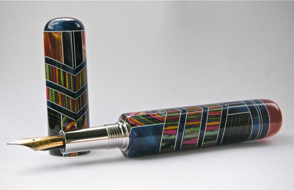

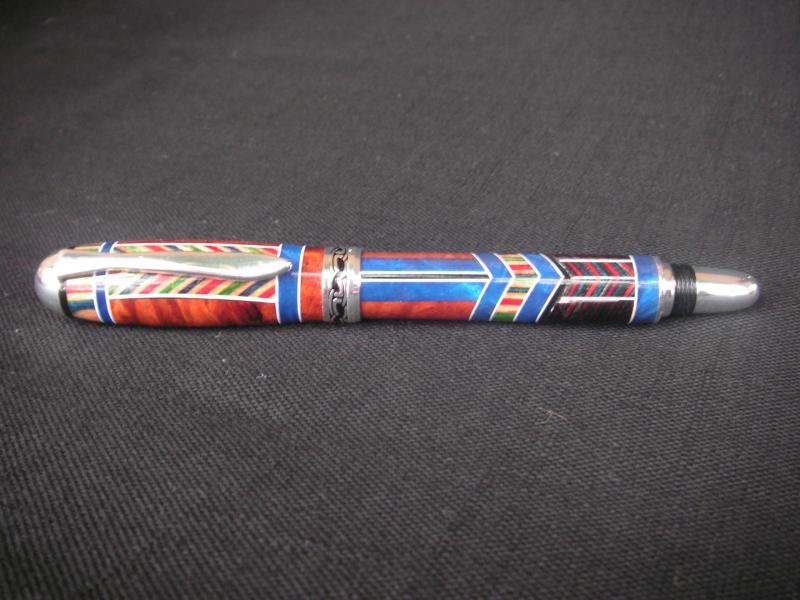

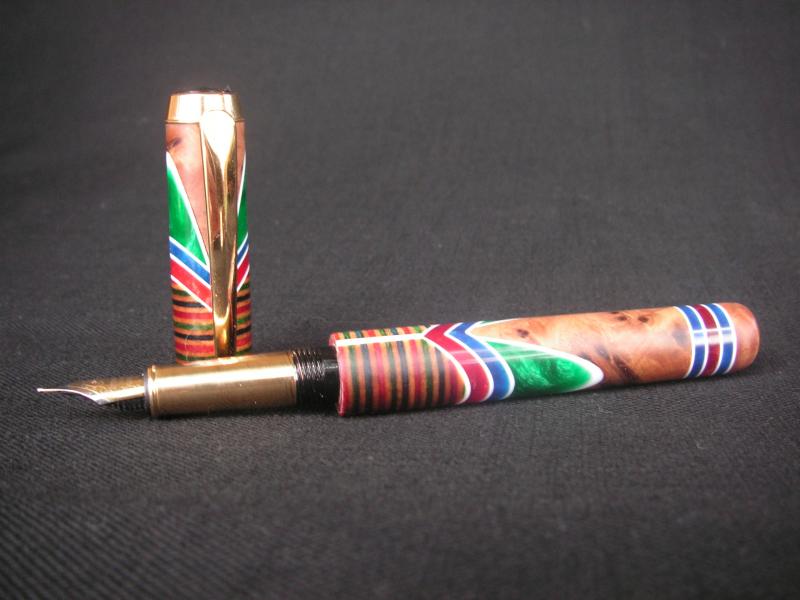

I used this as a guide to make a vacumm fence similar to this one, it works really well and is SAFE to use for those very thin cuts. Not really sure how thin I could cut with it but 1/16th inch is very easy to do and could do smaller if needed.
Here you go: http://www.penturners.org/forum/showthread.php?t=63131
Of course, a bunch of other forum members piled on with their opinions of it and their own designs, which you can read about. However, I do not like any of their designs better than the one used to make mine. Repeatable cuts are important to me when I want the same thickness from four or five types of materials. Here's what I mean....
Parson,
You pens are awesome!
I rememeber your sled thread from a while back, and just revisted it. I just don't quite get how you use it. You have that big nob on top, but I dont see how it would tighten into anything. Your results speak volumes, so could you please elaborate on the use of your sled?
The fence also seems to be like an L with a little platform at the bottom, but the blank in the pic is not on the platform.
Thanks
I put the material on the sled, adjust the thickness, put a piece of sacrifice wood on top of the material, pop the hinged bit with the knob over it, press down hard, and make the cut.
One of the pics shows the hinged wood brace with the knob on it directly on the material, but I do not use it this way. Sorry for the confusion. There's always a 1 x 2 x 6 between the hinged brace and the material.
The sacrifice wood takes the very top of the blade (1/8 inch or less) and holds both pieces in place through the cut.
I set up blocks on the right side and screw them down when I need to cut angles, but I rarely do this. I cut straight pieces and then use my drum sander to get the right angle of the edge. Doing second cuts of thin material at angles seems to chip out material too much.
