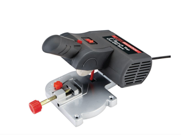

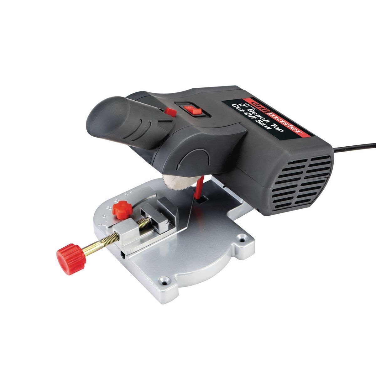

I have one of these little saws from Harbor Freight and it works great.
I cut a lot of 10" tubes to length for various reasons. I have not found a way to cut them to the exact length needed. I cut them a bit long and tune to length on the disc sander I use to square pen blanks. I am not happy using tubing cutters at all. I have a small "razor saw" with a metal miter box. I also use the band saw (with proper blade) and I use the small cut off saw sold by Harbor Freight and other. Cutting long and tuning to length on a disc sander has worked well for me.

Carbide wheel pipe cutters crush the tube too much and saws regardless of the type do not leave a clean and square enough edge. I use a somewhat larger version of the HF saw like Scott (woodwzrd) showed- it has a little more power and uses 4-inch cut off wheels. Then I do as Don (its-virgil) does using my disc sander along with the appropriate sleeve to fit the pen tube. It works great! - Dave

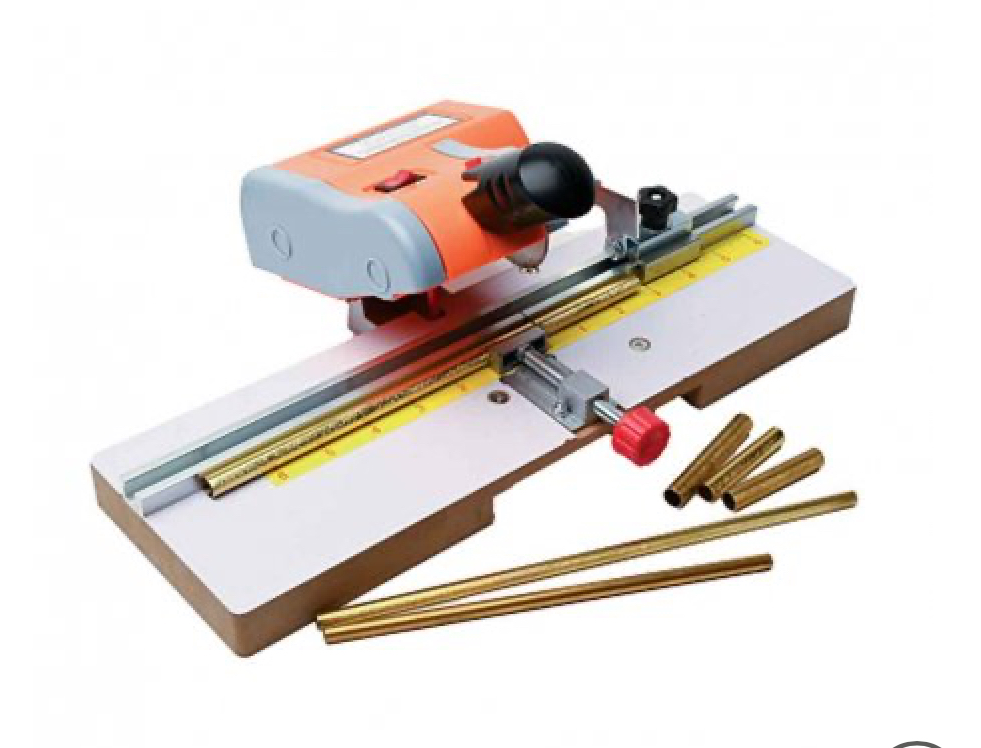

I used to use the band saw and chop saw trying to get consistent lengths. I bought this one with the fence and adjustable length stopper and can cut perfect lengths now. I know I will have to replace the saw at some point because they are not built to withstand constant use but it appears to be an easy swap on the base with a couple screws. It's worth the price to cut perfect length tubes 10 x faster than I did measuring each one.

I did what John U did. I started the way you and most others did and wasn't happy. Then I bought the one that Woodwzrd posted and it helped but the bed of the saw isn't even with the clamp. When I bought the last one all my issues were taken care of. The base and stops make all the difference.

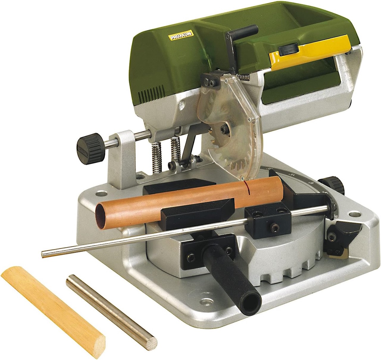

Not cheap but well made and should last.
I like mine...
