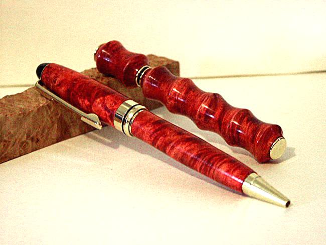

That is not like any BEB that I have ever seen.. but it looks just like some nice big leaf maple burl that I have that made some gorgeous pens.... a definate winner for pen material... don't forget to cut some to 3" lengths for Atlas pens..
BTW... that stuff takes stain real well also...see the set below
BEB...BEM...blah blah blah....it sounds like the teacher from peanuts talking. Do you soak the pen blank in dye beforehand or do you aply it after finishing the pen?
