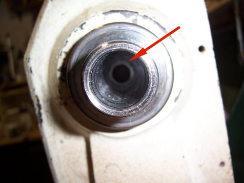

I have heard that a picture is worth a thousand words....... so I like photos!
Here is a shot of the headstock spindle on my Jet Mini lathe. See the ridge the arrow is pointing to, that is where my taper stops, exactly 2.82" from the spindle face. So, turbowagon's drawing is pretty well spot on and we've all learned something!

Yes, now we have learned something for sure, although why it would be like that is unknown! Must be one of those genius engineer ideas.. "Hey guys, I got a great idea. Lets make a little wall inside the spindle so that the tapered center can't accidentally push all the way through!" :rotfl:
