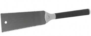

I usually use my bandsaw,(and think it is probably the safest method), but since I moved my Jet mini into the basement and I'm too lazy to run out to the shop, I just use my Japanese saw which looks a little like this ...
