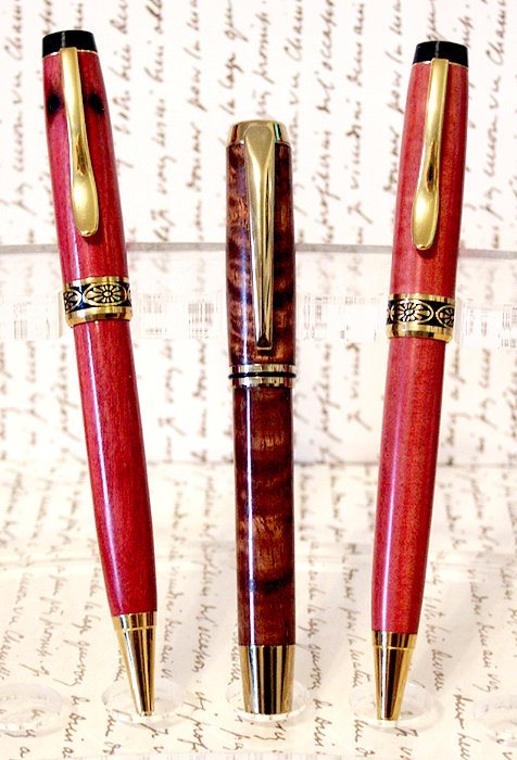

Here is an order I just finished for a customer...
A Perfect Fit Convertible Pen/Pencil Set in Pink Ivory and a TI Gold Jr Gent FP in Curly Koa...
Pink Ivory sanded to 600, Cellulose Sanding Sealer buffed with 000000 wool cloth, 3 coats of TSW over 2 days and Ren Wax... biggest problem with PI is that you never know if you are going to find those little black "beauty marks" in the blank.. I was lucky on the pencil, while I did find 2, they were side by side and balance the clip nicely..
The Curly Koa is finished the same as the PI..
Occassionally you will find small dark almost black spots in the PI... I believe they are thorn remnants or in some cases insect holes... if you are lucky they are on the outside of the blank and if near the end you can work around them.. in this case they appeared as I was turning down the blank.. both of these were voids that I had to fill with CA and then recut lightly before final shaping... but luckily they were balanced and don't look bad...
On top of that they were the only two PI blanks I had left that were almost the exact same color...
