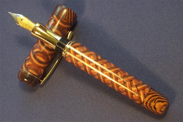

I do it all the time. I turn a tendon on the end cap that fits in the tube and just rough turn the part that will be the final. I hold the cap on a pinchuck and insert the final and turn it like a one piece solid body.
You mean something like this?

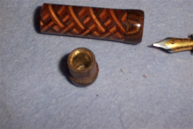

It isn't a simple matter of a tenon.
the cap is hollow so the nib can fit into it if you goofed on your dimensions
Yes, Eagle, JUST like that. I LIKE THAT PEN, great work. I hope you're getting several c-notes for pens like that!
I see how you did that-- I'll use the plunge caliper to measure how much nib clearance I have before making the tenon, and I'll funnel the shape a bit IF I go that route. The problem is that I have already put the ti-gold cap on the refill-end of the pen, so it will look a bit lopsided with a gold cap on one end and a wooden cap on the other.
