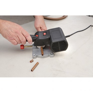

I use this little guy from harbor freight. Makes a nice 90 deg cut.
Does that thing actually work. I have looked at it a few times. Does it leave a clean edge?
Yes, it really works! It has a little vise built in to hold the tube, and it cuts pretty clean. Replacement blades are available at HF. It leaves a little bit of burr, but I just rub it on a piece of 220 sandpaper laying flat on the workbench to clean up the edge.

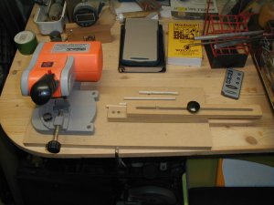

I also have the Harbor Freight cut-off saw. I added the base and then the slide (to the right in the picture) to allow tubes to be cut to the same length. Note the 1/4" dowels on top, they are set for the ones I cut most often and allow me to set the slide the same every time.

I like your set up Ron. I have the same kit except I did not make that homemade hold down that you made!
Ron
Great idea. I usually just use a clamp to hold a stop block but this is much more elegant.
