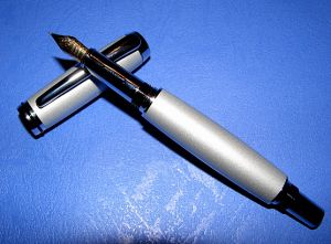

Here is a Baron in aluminum;

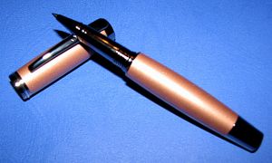

And a Jr Gent in copper;
These were turned on a Jet 1014 with common woodturning tools, by hand.
