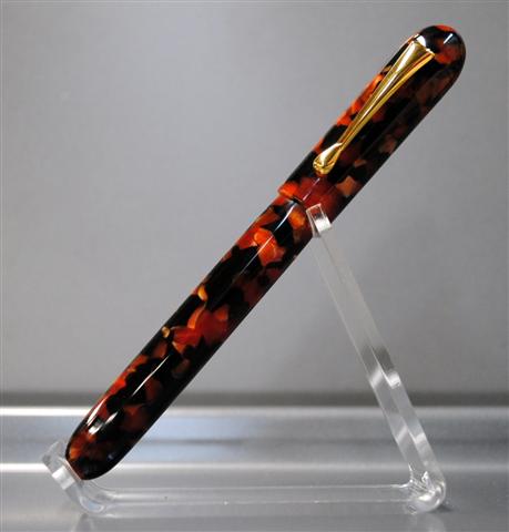

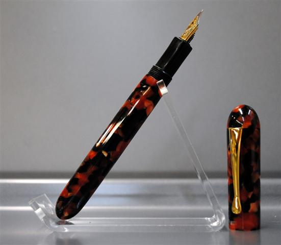

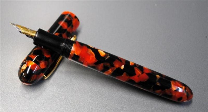

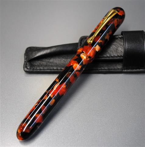

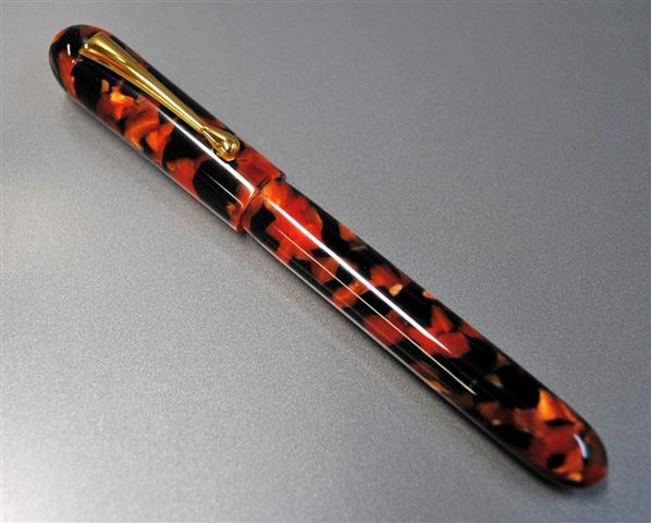

I loved the intense color of this imported resin when I first saw it. Semigloss ebonite section carries threads for the cap.
5.5" capped
4.8" uncapped
Cap is 2.3"
Diameter at clip is 5/8"
Weight w/ converter is 22 grams

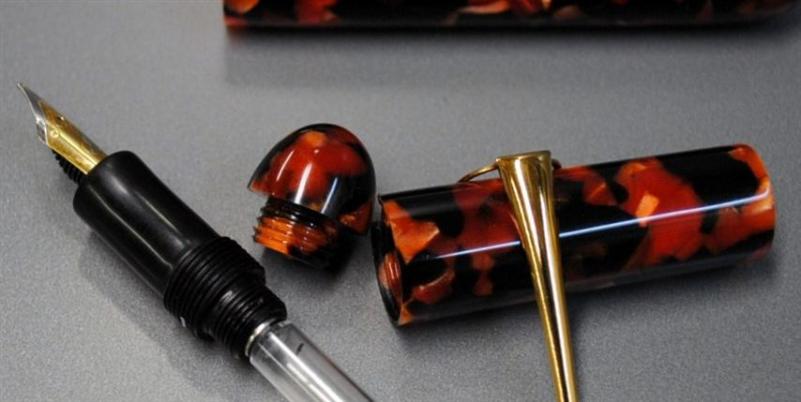

Threading:
12 x .8 barrel-cap join
7/16 cap-finial join
9 x .75 section-barrel join

So it looks like a friction fit to post? Did you drill a 7/16 hole in the cap past the threads to accomplish this? I'm struggling to make posting finial threads that don't look out of place and would like the friction fit option myself.
The cap doesn't post Lyle, but I'm going for that next time. I did drill the cap 7/16 for both the barrel-cap threads and the cap-finial threads--in other words, right through the cap.

Ah, cap finial. Got it. I really like the shape of this one. Have also toyed with the idea of putting cap threads on the section, but haven't tried yet. If you screw the cap on tight, do you ever have the section unscrew when taking the cap off?
I really don't like postable pens for my own use, but feel like I need to make them post when I make them for other people. I just haven't liked how mine look yet.
Yeah, I worried about that too, and the first time I unscrewed the cap, that's what happened. I killed some cap threads so that the barrel threads don't bottom out and that seemed to take care of it.

I like the pen but I would think the serction would be too weak to stand up to the repeated use of screwing the cap on and off
Joe, I posted this in another thread and I think it applies to your point:
On the subject of the possible risk a section breaking because of having cap threads on it, I may regret this but I doubt it's going to happen. I think I have more meat under the section-cap threads than I would have on a barrel when there are cap-barrel threads right over section-barrel threads.
Of course, you can move the the cap threads back on the barrel to avoid that, and then the issue becomes one of aesthetics: Where do you want to see the threads--forward near the nib or backward on the barrel?
Another aesthetic issue is the ratio of cap length to barrel length. I like a shorter cap, and putting threads on the section allows that.
Again, this is a novice speaking. I'd appreciate the opinions of the guys (I don't think there are any women in this category) with the experience.
The way you put the threads for the cap is nice. There is a lot more meat there that way than on the body and allows the cap to be shorter.
