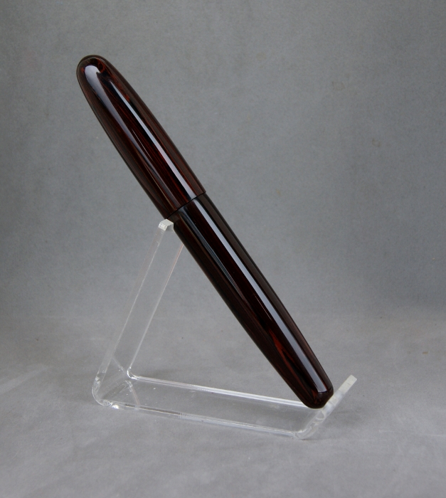

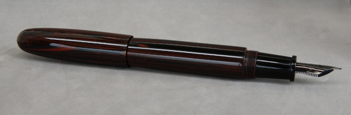

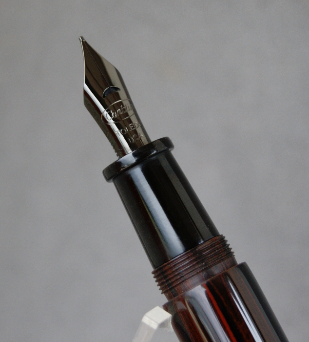

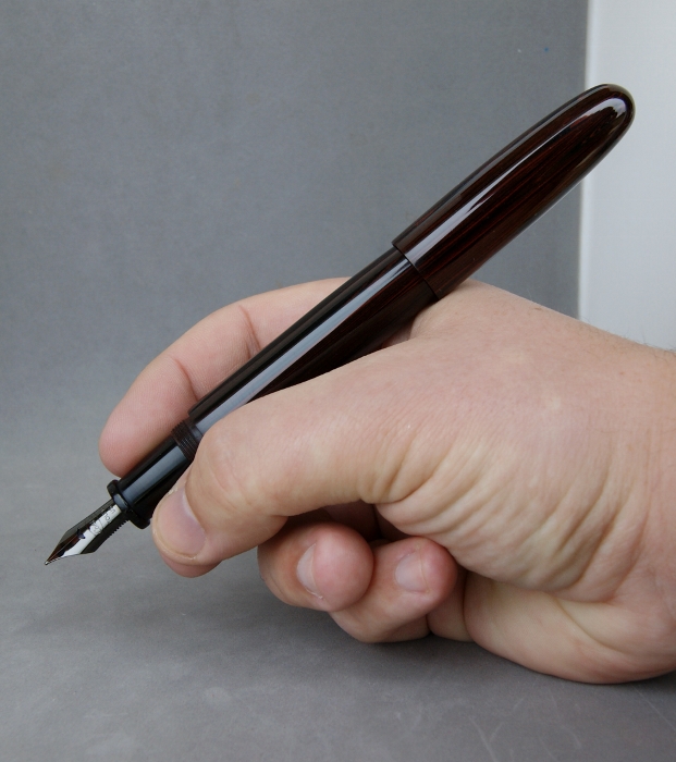

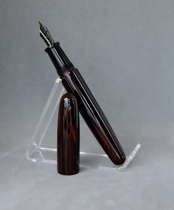

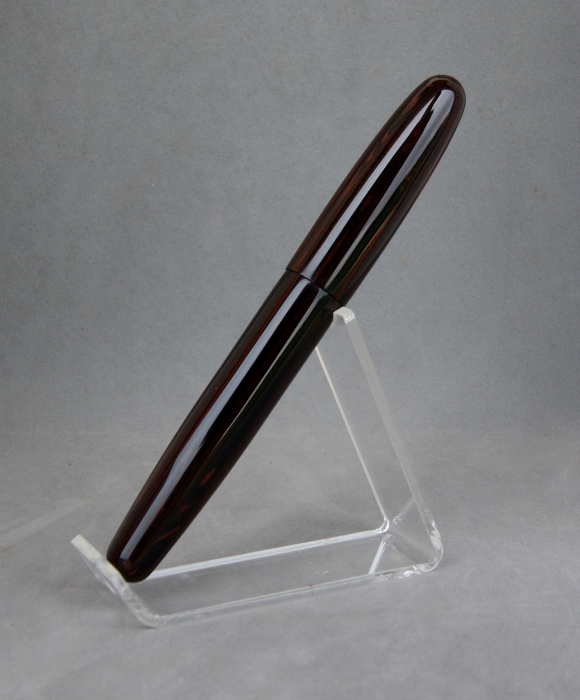

I've been having a lot of fun at the lathe lately. This is the newest creation of mine. I'm really liking this clipless design. Now I just need to make some matching pen pillows to go with them. I do have to give a shout out to my buddy Tyson (Jyreene) for giving me this awesome nib. It only took me 6 months to put it to use, but I think I found the perfect home for it!
Here are the specs.
Materials
Cap/Body: Cumberland Ebonite
Section: Black Ebonite
Overall: 5 3/4"
Posted: 6 1/2"
Body: 5 1/8"
Cap: 2 7/16"
Threads
Cap/Body: 14x.75mm Single Start
Section Body: 10x1mm
Nib & Ink
Conklin M - Black Titanium
Cartridge/Converter or Eyedropper
I was trying something new - let me know what you think! I know I didn't get it centered on my backdrop :redface:
Thanks for looking!
