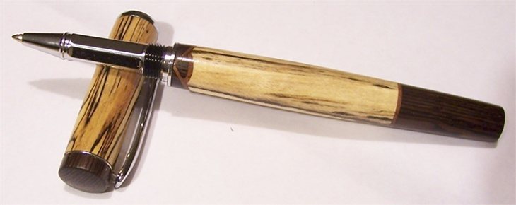

I have taken a break on pens lately to concentrate on improveing some of my other turning, but I am going to see an old friend that I have not seen for 11 years next week and he asked me to make him a pen. The kit is a baron and the pen is made out of spalted maple and wenge with jatoba accents. I have to say this is the best fit I have gotten so far on a custom final.
Comments and critiques are appreciated.
Thanks for the comments everyone.
Kevin - I know lots of turners hate Wenge but I think it works very nice as accents for zebra and splated maple. I actually think it turns okay I dislike the open pores but can live with it.
Ray - I have been working mostly on turning bowls, hollow forms, birdhouse christmas ornaments and pepper mills. Alot of my shop time has been making hollowing tool and such. I also am working alot of finishing my turned pieces and am making a big (for my mini) segmented bowl. The bowls are finally starting to turn out okay but still need a little work. The birdhouses need some work and my first peppermill was a dismall failure.
Super looking pen!! Is the finial turned so that it is a press fit in the tube just like the standard finial that comes with the kit?
Originally posted by Jerryconn
<br />Super looking pen!! Is the finial turned so that it is a press fit in the tube just like the standard finial that comes with the kit?
Yes it basically is turned to look just like the kit final. I do use epoxy and glue it is place to make sure it stays put. I actually turn the tendon to fit in the tube then hold the cap section on a pin chuck with the final piece inserted in the end and turn in as one piece to insure everything matches up good.
