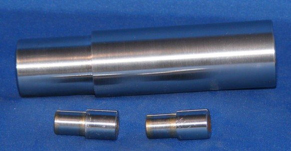

I was so impressed with John's work on the bushing he has made for us that I started working on a project with him. Here is the result.
The Bushings in front are my used sierra bushings. The one in the back, well....... let's just say we are working on a new kit. ;)
Actually, When I bought my Grizzly lathe it has a 1 inch post on the toolrest. The PSI lathe that I was moving up from has a 5/8's inch. Since I had just replaced the PSI toolrest with a 3 piece set after I broke the original, I couldn't see spending another $50 for a 6 inch and 8 inch tool rest for the Griz. So I contacted John and had him make up an adapter to make the 5/8's tool rest work with the 1" bango.

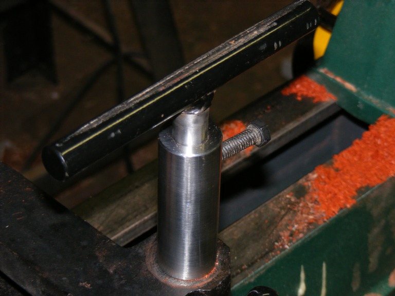

Here it's in it's new home.
A Big thanks to John once again for providing a perfect product.
I love the hardness as it is steel. I don't get and nicks in it at all, but it doesn't allow you to get as close to the workpiece as the stock (non-round) rests. Tradeoffs.
There is an extra gap of maybe 1/4 inch, but it doesn't change what I do too much.
Mike,That looks like it should work real well
for you.I'm glad you like it.
Thanks for posting it up.:)
I could make a set of these for telephone pole pens,
if you ever get a BIG lathe,and we'll call them bushings![:p]
I need to make myself some round rests,looks like
the way to go.
My tools drag on the flat one I have.
