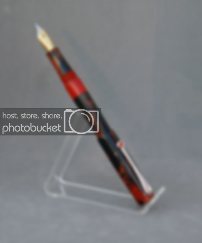

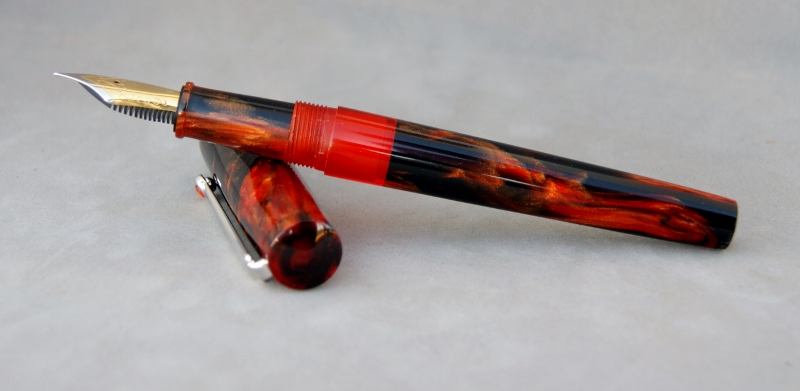

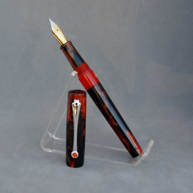

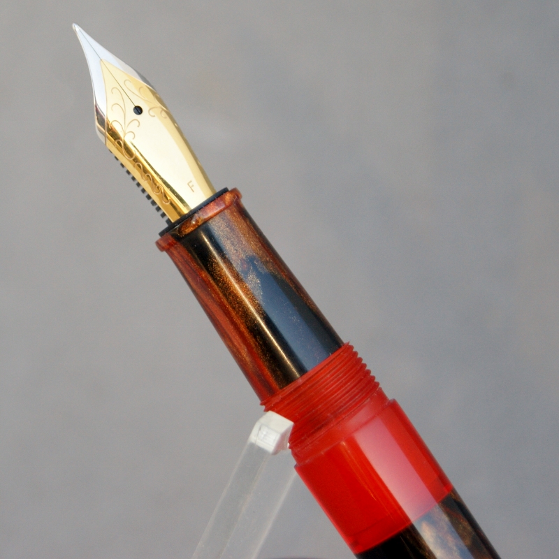

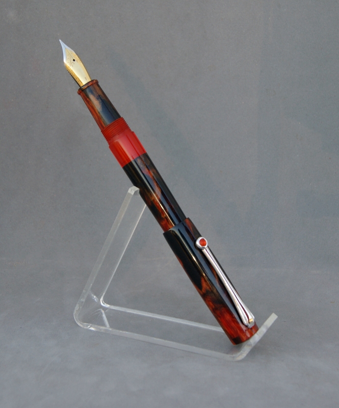

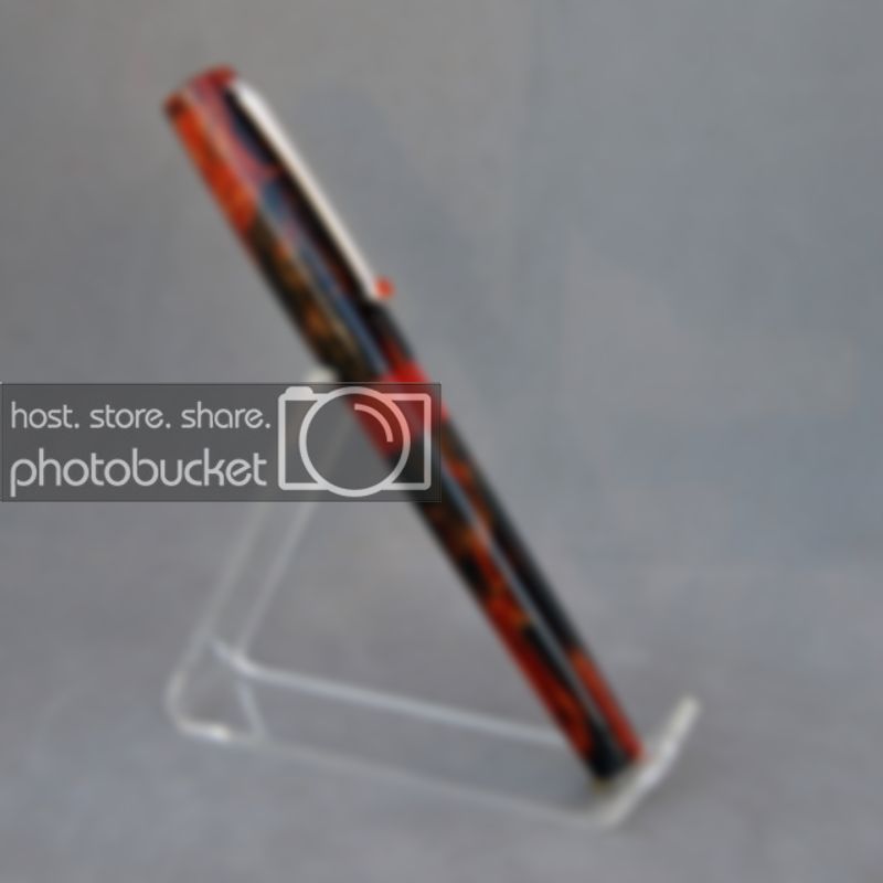

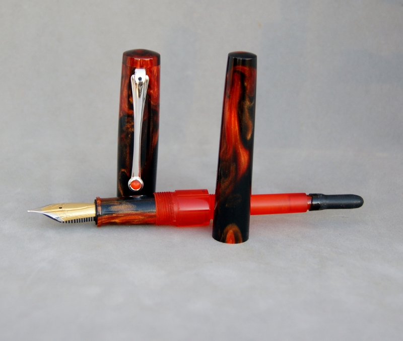

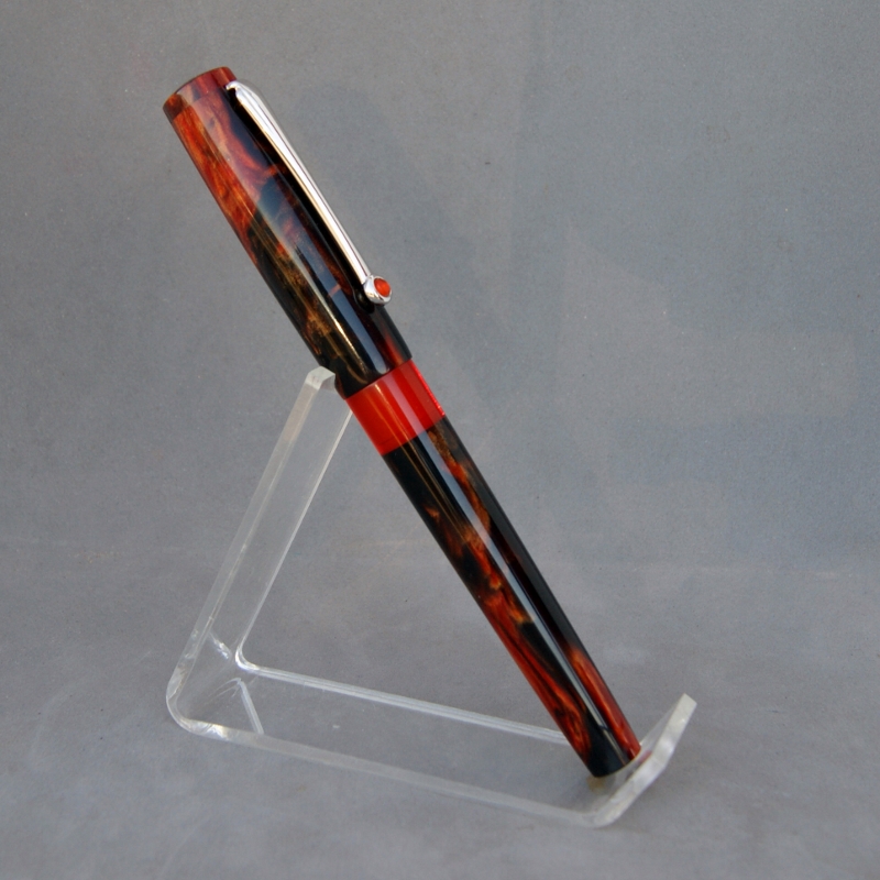

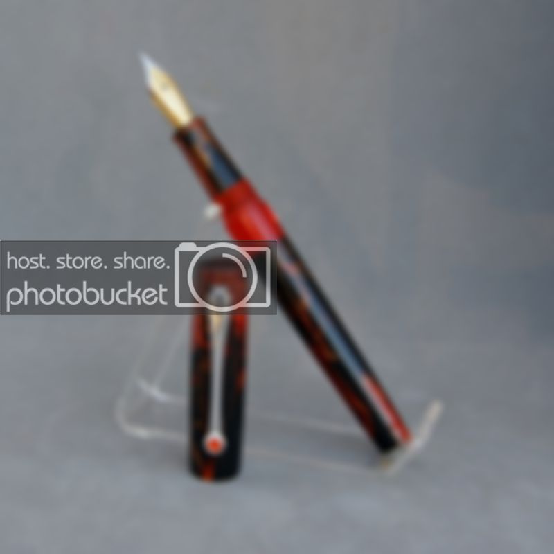

I just finished this earlier today. It's a custom bulb filler FP that was commissioned. A lot went into this design. Some of you might remember my recent bulb filler prototype (http://www.penturners.org/forum/f13/custom-bulb-filler-prototype-127375/). Well here is its #1 production model. All trimmed down and much better looking.
I had artistic freedom on this project so I tried to go all out. I chose to go with my Combustion along with a translucent orange ink chamber and clip inlay.

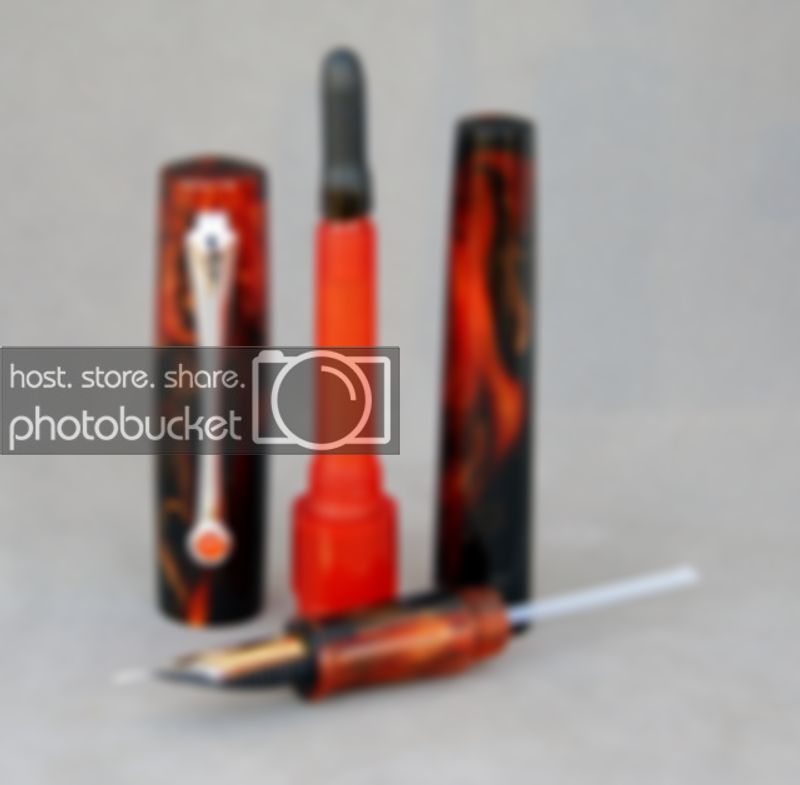

Dimensions:
Capped: 5 3/8" ~ 137mm
Cap: 2 3/8" ~ 60mm
Body: 3 1/4" ~ 83mm
Body & Nib: 5 1/16" ~ 129mm
Posted: 6 1/8" ~ 156mm
Ink Chamber: 2 1/4" ~ 57mm
Section: 3/4" ~ 19mm

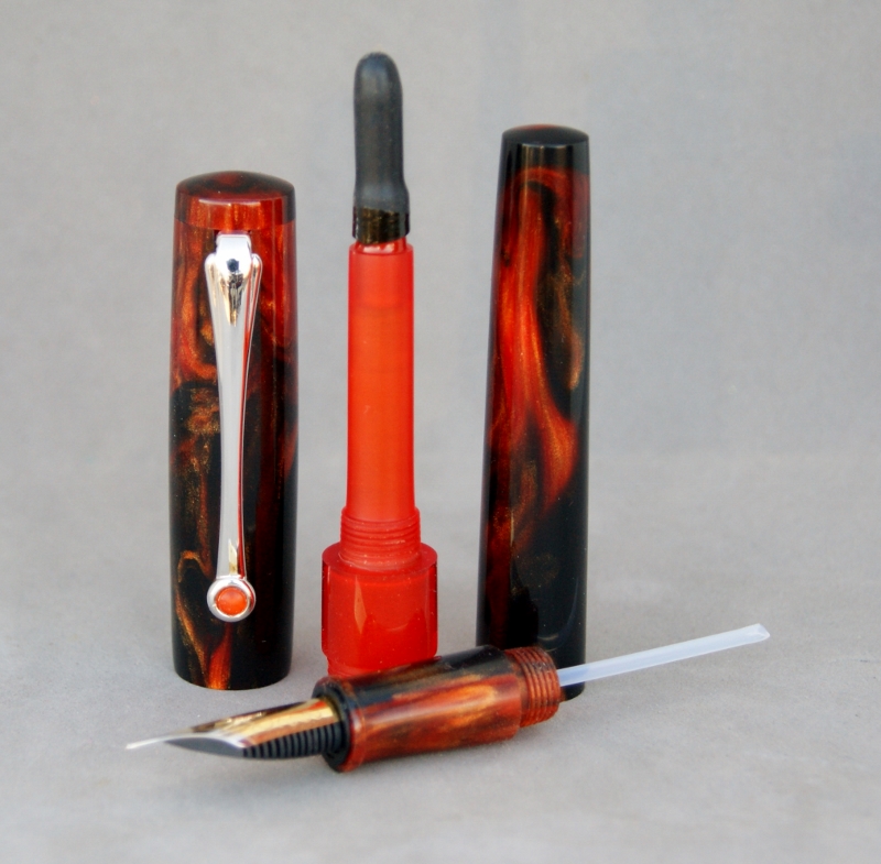

Threads:
Cap/Body: 12x.08mm Triple Start
Body/Section: 9x.75mm
Ink Chamber/Body: 9x.75mm

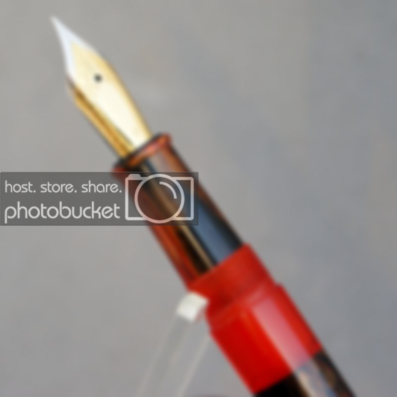

Nib & Ink:
#6 Two Tone Jowo - F
Bulb Filler - #14 ink sac

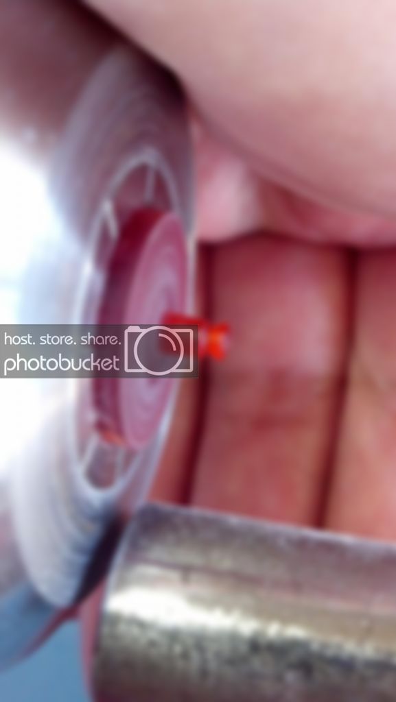

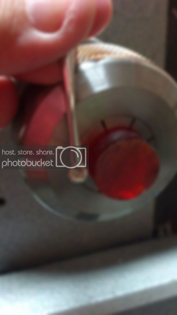

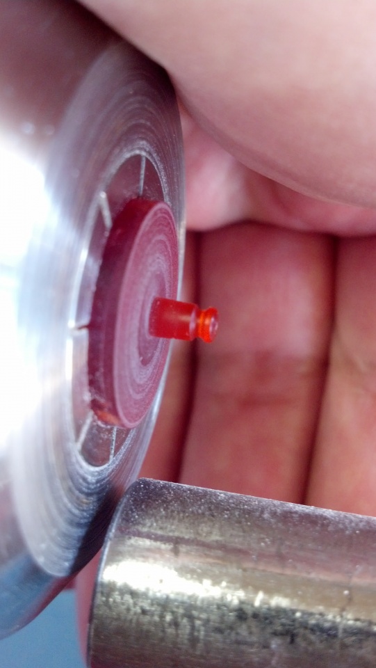

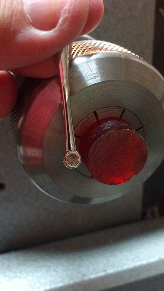

Here's a bit on what I did for the clip inlay:
The final dimension for the inly was just under 3mm in diameter and only 1mm thick!
A very fitting pen for my 5000th post I might add :biggrin:
Thanks for looking!
