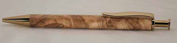

I've found thin CA as a first coat seems to work pretty well. Here is a sample of some maple crotchwood that I used CA on.
