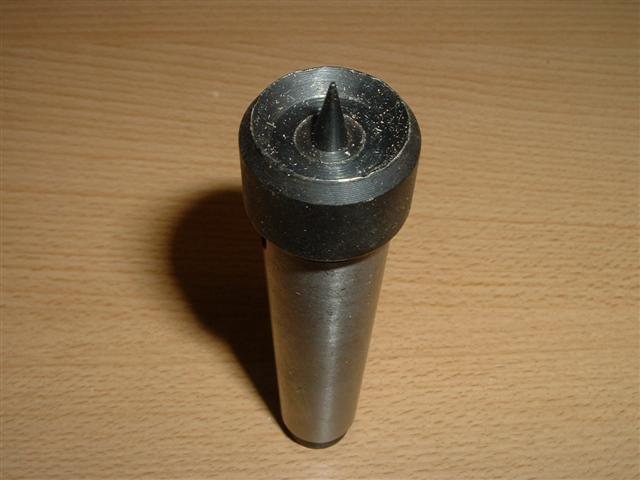

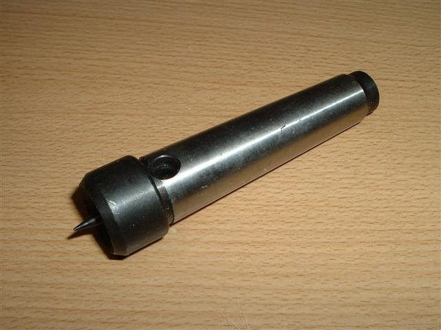

This is what I have.... It's a #2 taper. If your interested please email me through the forum and we'll come to terms.
I'm open to a trade if money is tight. This is one that sears used to sell for about 12 bucks IIRC

<br />What Mudder showed is a cup center. It is for the tailstock. And they come in a wide range of prices. About $5.00 from Grizzly and up to the "Oh, my gosh" range for European made.
They are also used as "safety centers" Many turning instructors will start their students with them. You might want to have a look at Alan Lacers skew video. It really helps get a student to not be afraid of the "catches" when using a skew.
Also; I don't believe that Grizzly sells these anymore. They do sell a Cup live center for $7.50 though.
