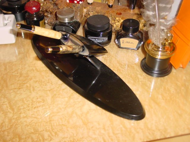

Here is the pic of what I do with pens with no caps (ussually the plastic friction fit) I buy old desk sets & refurb them. This is one of my favorites, a Parker from the 60's looks like it came out of the Jetsons or the front end to my dads old Buick. This is a pair of Americana rollers, that ended up capless [:D]
