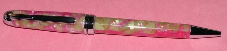

I paint mine to match the blanks. I just finished a pen for my daughter that was pink and jade. I painted the tubes pink using a flat model paint and it hid the tubes real well:
