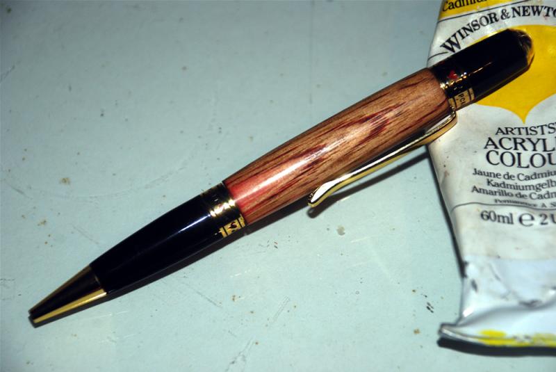

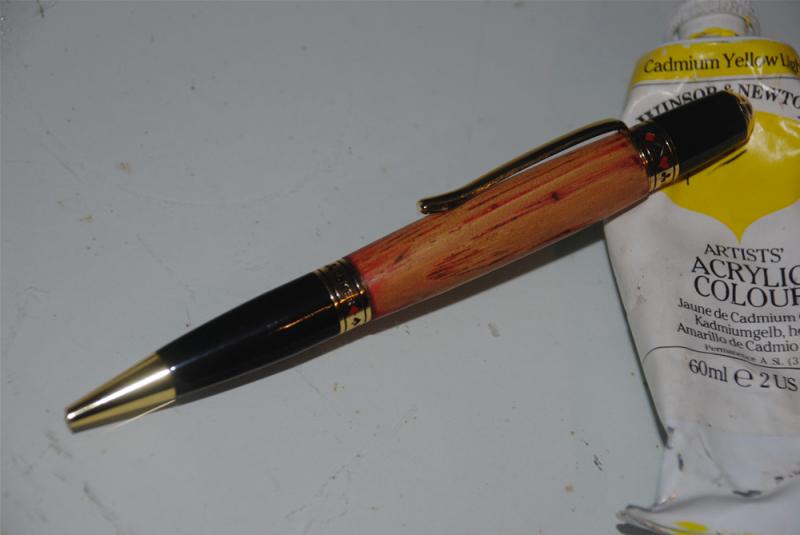

Don: Here is the maple burl. The blank is cut "pround of the nib" by using the incorrect bushing. I think a pink haze is almost evident. What do you think?Pens - 11-14-09 Maple Raspberry Crystal Lite.jpg
