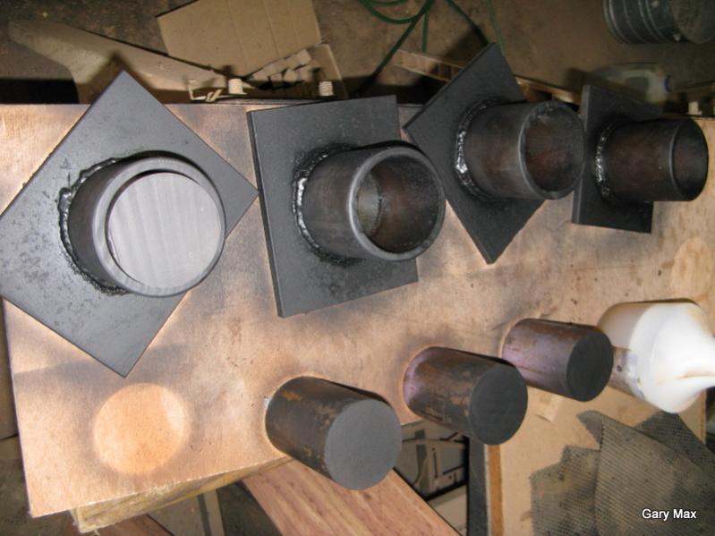

I like using crushed stone for inalys so I came up with a stone crusher. I started working on this back in Aug.
I bought enough steel to make four of them at once.
Still haven't test drove one yet but it should do the job.

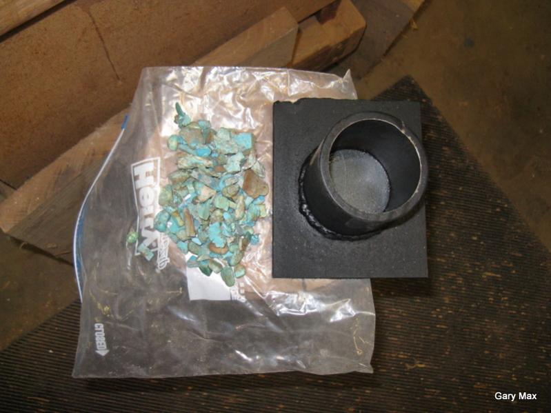

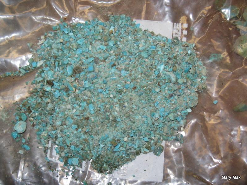

It works like a charm-----now I need to set up a sifting screen and I can make my own Crushed stone---I have a good supplier for stone.
I wonder if I can crush something hard like Jade ?????????

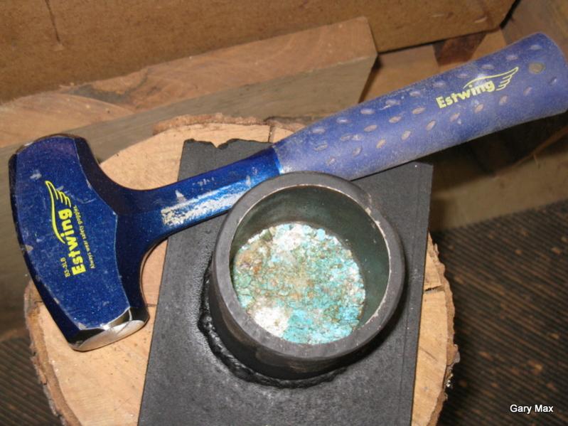

It works------even on Jade.
This was a solid block of Jade when I started.
I am only using a 3lb hammer

Packaged one of theses up--- heading north----it weighs almost 10 lbs. The biggest thing I can think of is make darn sure you are using a solid surface when crushing stone---I stood a log on end ---worked perfect.

The BIG reason I made mine ----have you ever priced what they sell crushed stone for. I bought some off ebay and you got a tiny baggie with two teaspoons full of stone.
I don't remember how much it was but I knew that was the last time I bought it that way.
