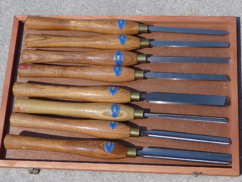

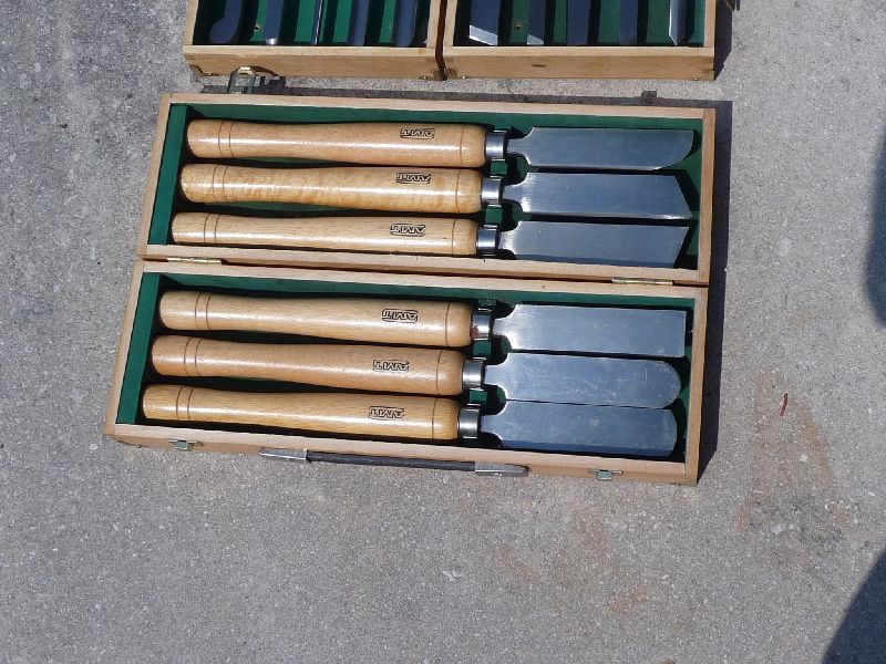

Hello, folks, I just got my hands on some turning tools that one set has the label bands ( Crown tools from Sheffield England) the other set is AMT turning tool set. I'll try to post pictures tomorrow. I was trying to find out when they were made and what they are worth, however, when I googled them I couldn't find anything. I was hoping that some of our older (in turning years) members can help or direct me to them. Or, if you can remember where these gouges were sold and what type of steel they are made of?
These are the pic.s I added 5/24/11
AMT (American Machine Tools) Is still in existence but as a pump manufacturing company, I believe the got out of the tool and lathe business 20+ years ago.
Phil -- AMT tools was around in the 80's and perhaps the early 90's. They imported some tools that were different, and had decent quality high carbon chisels for carving and woodworking in general. I have some large fishtail gouges that are pretty well made, but not especially finely polished/finished.
I never saw lathe tools, and cannot comment if they were high carbon steel or high speed steel. Nothing wrong with a high carbon tool -- as long as you do not get the edges the least bit hot while grinding, and accept that the edge will need to be sharpened more often than a high speed steel tool.
Ken, If you get chance , please take a look at the pic.s above, and thank you for the info.
Phil -- I am not aware of any non-destructive methods of testing between High Speed Steel (HSS) and High Carbon Steel (HCS). Current practice is to mark HSS on tools, but I have a couple older ones I gathered up (a bob stockdale gouge comes to mind) that look to be HSS but are not marked. (that tool has not been to a grinder and I have not needed to use it - so it is still as new).
Distructive - or alterning methods include -- taking a known HCS steel to the grinder and comparing the spark pattern. High carbon steel has a different spark pattern than most HSS at the grinder. Another is to heat it to blue color and see if it has lost it's temper. HCS will become softer as it is blued where HSS will not lose temper until about 1100 degrees F. High carbon steel can be re-hardened and tempered, but it will not be shiney in a box if you were thinking of selling it. There are internet references with descriptions of the difference in spark patterns, but I find direct comparison on the same wheel in the same light make the choices easier to discern.
Side note -- the quality control of 20-30 years ago with high speed steel was not a rigerous as it is today. There have been a few technical improvements over the past few decades. Old HSS likely will not perform the same as the current steels, especially the powdered metal steels. Expect the AMT and perhaps the Crown tool to be more comperable to the Bens Best or similar in terms of durability of edges.
All my tools except for the woodchucks are crown tools, and I've only been turning a year. I really like them. They take and hold an edge really well.
If they are very old, they are probably not High Speed Steel, so be very careful sharpening them not to get them too hot and ruin the temper in the carbon steel.
Have never owned a HSS tool that did not have a stamp or stencil on them. Cannot see any markings on tools in photos. My old Sears tools claimed to be HSS, but were carbon steel. I wore them out! yes, blued the edges more than once learning how to sharpen.
JMHO, think you get a cleaner cut with carbon steel tools that leaves a smoother wood surface. If you have a light, touch at the grinder and touch up with slip stone between trips to grinder carbon steel tools good op. Talking about skews, and gouges and scrapper and making a final pass with very light touch. Only downside to carbon steel tools is cost. Quality carbon steel tools cost as much as HSS today. HSS steel has become the standard, but not all tools created equally.
Old carbon steel tools really do not have much value. Turning tools are consumables so not much appreciation for antique turning tools. Remember there have always been steel brokers in Sheffield England, does not always mean tools made there. Some turning tools claiming Sheffield England heritage not even cut to length and bevel put on them there.

Ken they look good to me and they look like they maybe HSS, but I emailed them to the site above and waiting to hear form them. I figured that I am not going to loose that much money on them until I become very good at turning and that'll be few years down the road, so for now it should serve me well. You know a man is bound to get lucky once in awhile in his life, huh? :rolleyes:
