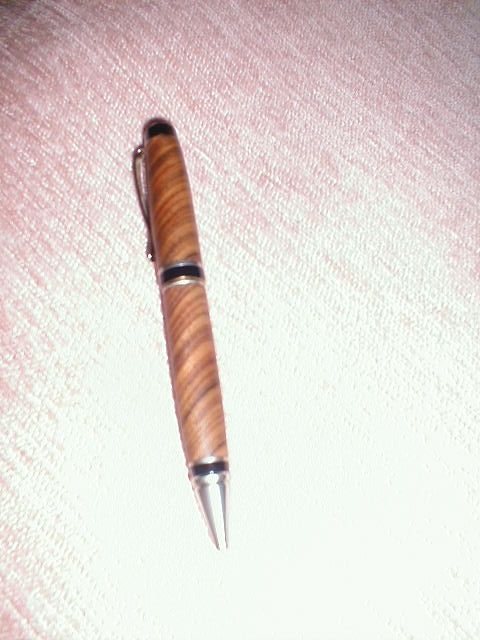

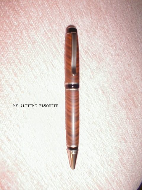

I have only tried one crosscut blank as of yet....
I used <b>a lot</b> of 5 minute epoxy on the tubes, razor sharp chisels (gouge to start, skew to finish). It was beyond any doubt, the hardest piece of wood I have turned. Chisels were difficult to keep on the wood. Tearout was a problem, so I left it at least 1/16th proud of bushings, and brought it down rest of way by sanding. Nevertheless, the results make it worth it! Sorry for the lousy photo. Mediocre camera, Worse photographer.
<b></b><b></b><u></u>
http://www.trade80.com/JCP/photogallery/photo00025353/liveoak2.jpg
This one is my favorite cross cut. From a live oak tree in my back yard. Sharp tools was a must. Took
twice as long to cut but looks great compaired to one cut with the grain.
http://www.trade80.com/JCP/projects/small_limbs.htm
Worth the effort.
