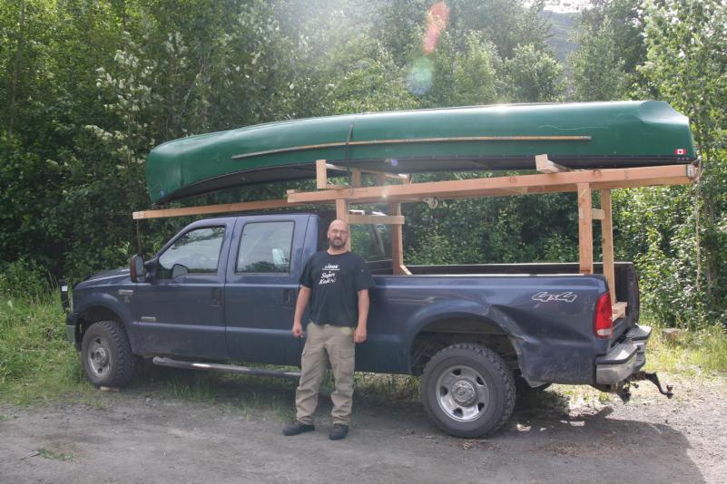

Mission Completed! Not as easy as it should have been and there is no way it weighs the rated 250! I learned alot for next time but it was more than a bit of a pain in the ass!
I have pics of the process but I it got hot, Alaskans dont get a lot of sun and I am having more trouble loosing the winter fat than usual.

Before you load this beast again. Find the furniture sliders (usually cheap at the big box store). Mount the furniture sliders (on a bolt) on your deck mounted rod holders.
Your rack design is perfect, the canoe just needs to slide easily during the loading process.....THEN, NOT SLIDE! I like the whole design.
Once the boat is loaded on the rack, you can remove the sliders or just cam strap it down. DAMHIKT!
A thought :eek:

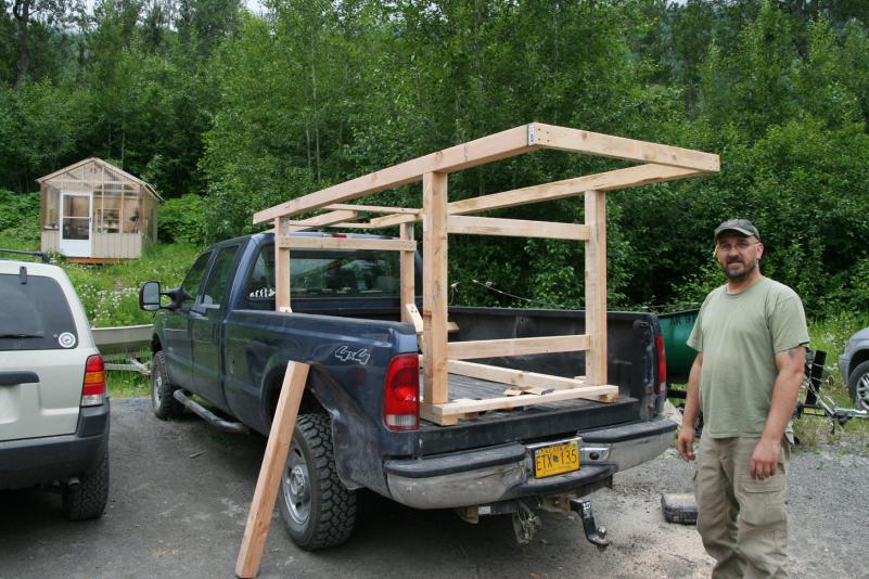

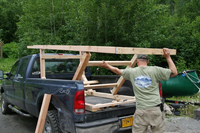

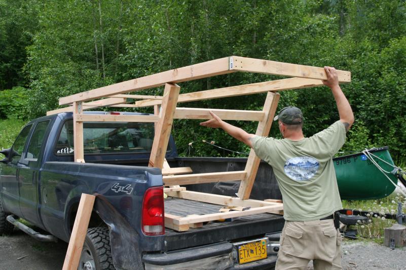

Make a pivot at the front legs so the rack can be dropped down at an angle if the rear legs are removed. For the rear legs I'd pivot them at the top to allow the bottom to kick out towards the back of the truck. Load the canoe the lift the rack up and use a trailer pin to lock the rear legs in place.
If that makes no sense I can make a quick sketch.

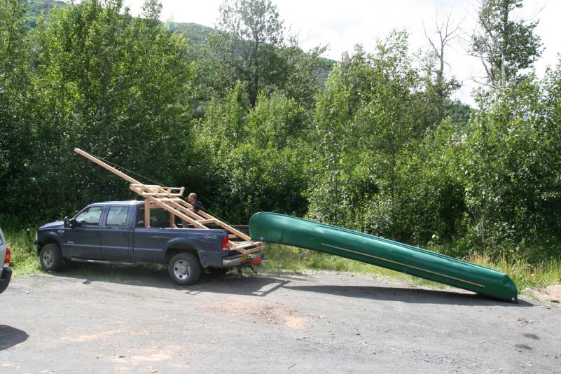

Like this Andrew?

Boxerman I used the one off the boat trailer, it proved insufficient for the job. That's why I say it has to be more than the rated weight. Next time around wheels for the stern of the freighter as well! I need to add rollers or go Penmans route. Makes perfect sence actually.
I throw my 400 pound mountain sled around like its a scooter.......that boat is heavy!
Phil no trees over the driveway and no trees at all on the Beaufort sea. Dont forget I and a 5 year old have to unload this beast once we get there. The hoist from my boat trailer did get put to use.........it just didnt have enough umpf.
