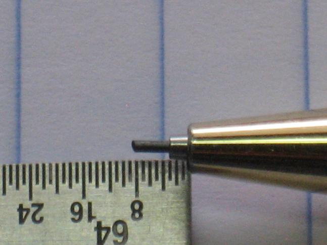

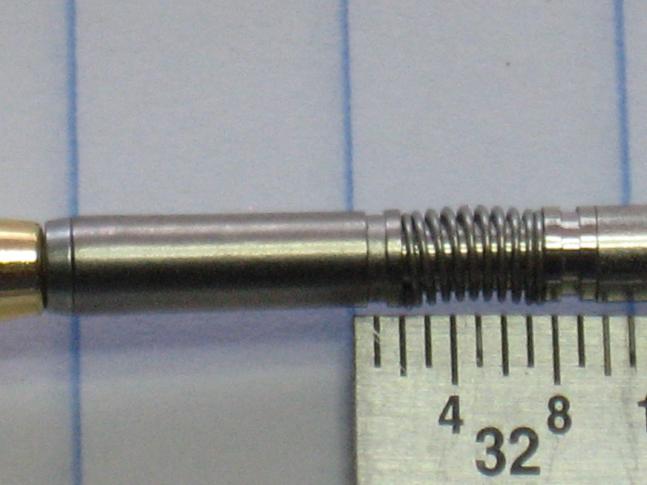

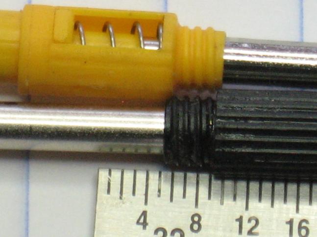

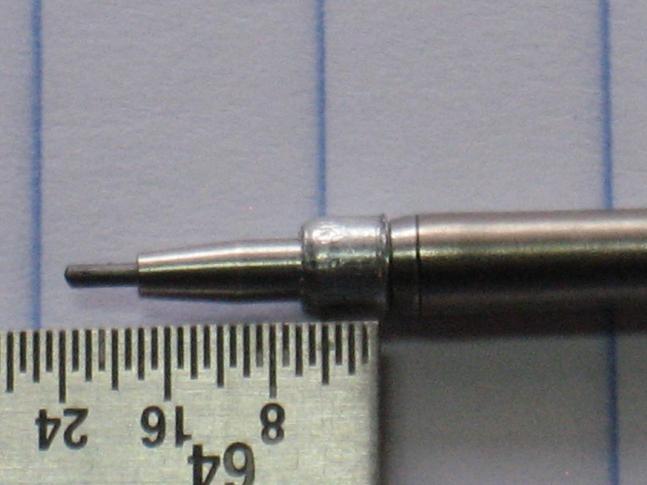

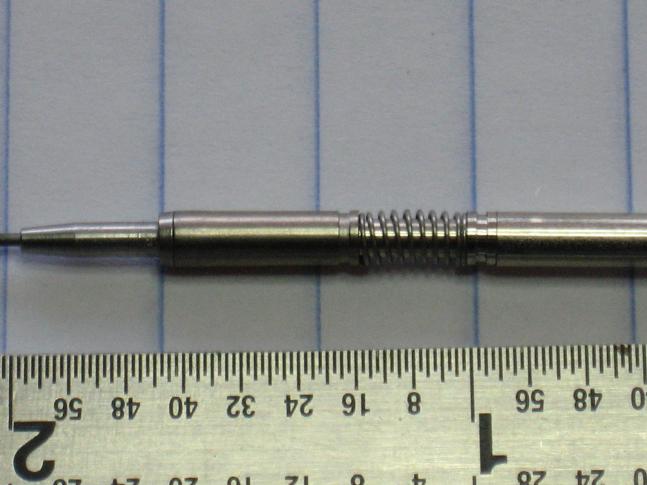

Understanding the Problem
Although we are putting the Switcch-It converter into a twist pen, it's not really twisting. Notice the spring in pic 1. At we twit the pen it extends and seats againest the nib. Continue twisting and the mechanism compresses (pics 2&3) extending the lead. The Normally configured slim line does not allow enough compression to extend and lock the lead in place. Solution: press the transmission in further till you get the correct action (pic 4). However it doesn't look good as the tip extends too far (pic 5) and a standard ink refill really sticks out...:confused:

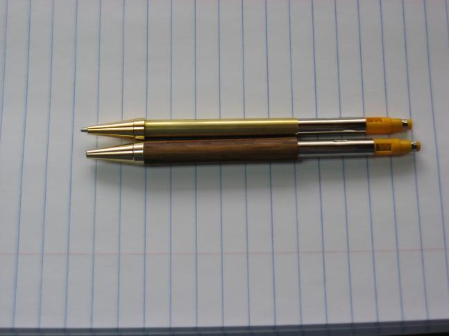

Possible Solution

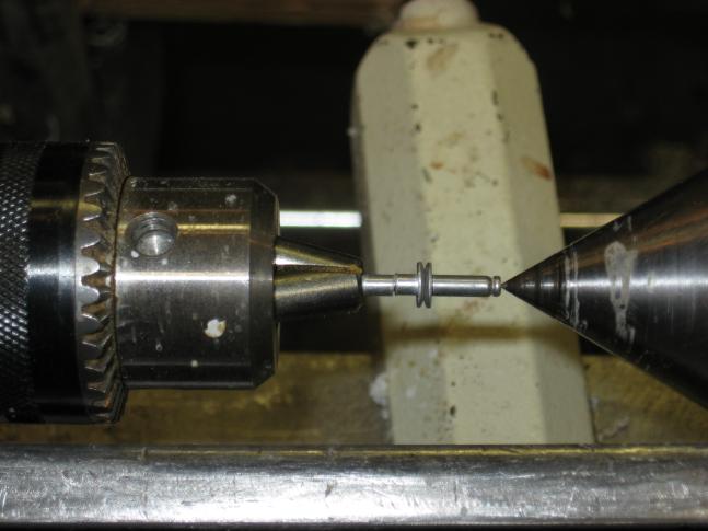

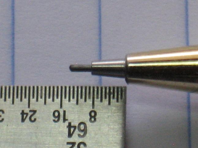

The differnce in length was about 6/64". What I really needed was a spacer. I looked around the shop and spotted a pop rivet I use to clean BLO and plastic polish nozzles. I slipped off the outer sleeve and it slipped snuggly over the pencil tip. I dug up a fresh one and mounted it on the lathe to cut off a small piece (pic 6&7). A slight burr helped keep it snug on the tip (pic 8). If it's too loose it may come off inside. Just try to get it out, DAMHIKT. Makes the tip look better and the ink refill works correct. Pic 9 is a pen with the transmission in the correct position.:cool:
The other issue of the loose threads I've temporarily fixed with a bit of tissue or tape around the threads. It looks like the threaded portion is a touch narrower and posibly a bit courser thread.:rolleyes:
Still working on a viable/sellable solution...
