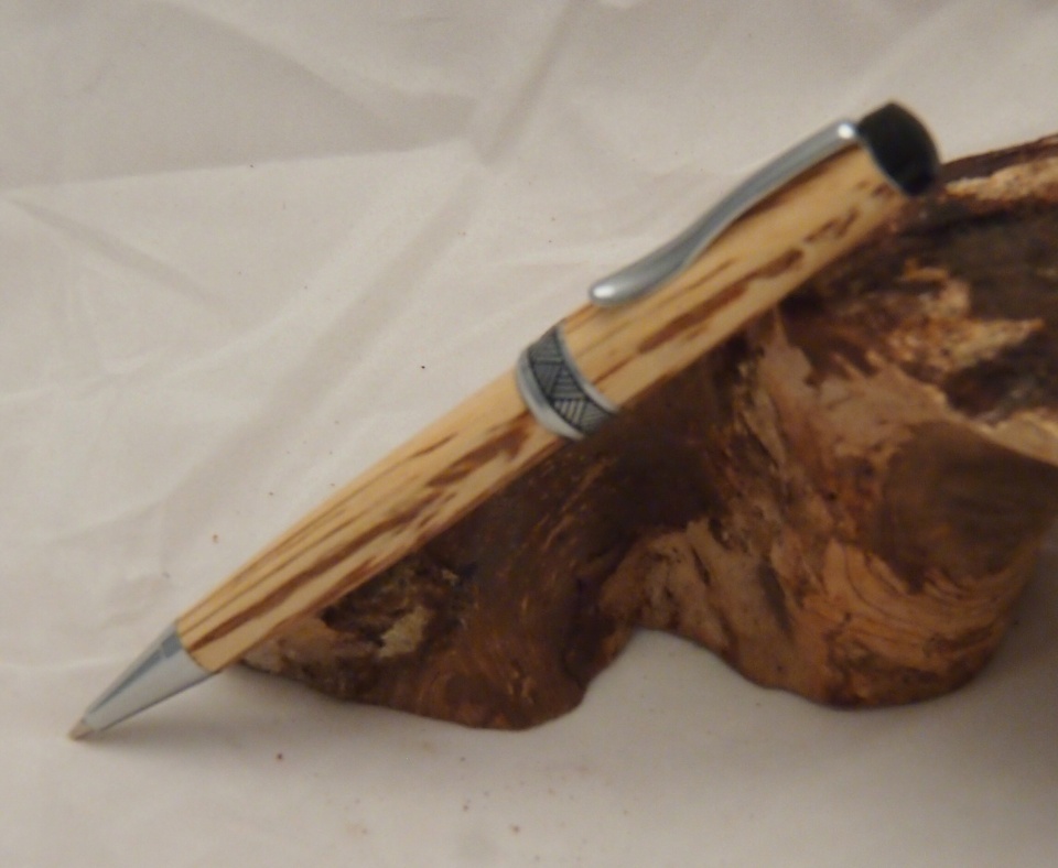

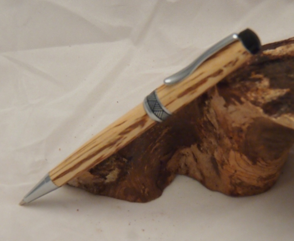

I decided to try the perfect fit converter with the schmidt converter from Bear Creek Woods and really like it. I hope it will stand up to heavy use. I did not want to buy the odd sized mandrel shaft so I made my first set of CTC corian bushing to fit this kit. Kit requires 4 different sized bushings so was a challenge for someone not accustomed to making bushings. Bushing were not perfect but worked well enough.
Spalted red oak found behind my house. Picture is a little out of focus.
