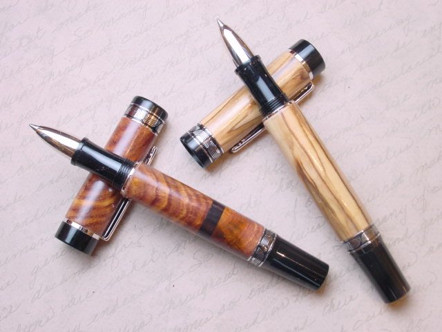

I think Bill threw this cross cut cocobolo in just to screw me up. :D
I did, catch a snag at the tail, so it got a band.:)
The other is a BOW.
I tried that Masters spary from CSU on these. I'll try anything that's
on sale. I sanded back the gloss a touch, I also used the sandpaper
they had on special and highly recomend it, good stuff.
Thanks for looking.

You were supposed to use the blocks I sent to practice cross-cut grain on first!![:D]
Looks fantastic with the band. Adds more character. Is that spray a lacquer? I haven't tried it yet as I still dip.

Hi Anthony,
How long does it take to dry before you can sand?
The pens look incredible!!
Looking good, Anthony! Nice job on covering a boo-boo. I just tried turning a crosscut piece of laminated bamboo...and blew out both blanks...well beyond recovery using any technique I've seen... [xx(] I did manage, however, to save the tubes. [;)] The second one wasn't as bad as the first, so I'm planning to give it another try.
It is a lacquer base finish. Was just informed comes in satin or gloss.
Jim, it dries to the touch in less than an hour, I waited about 4 hours
before sanding. I sanded by hand vs the lathe. I got a pretty comfy roller rocking
chair in my shop, and I can hand sand a dozen barrels in less time then putting
them and taking them off a mandrell. I would just lightly sand 600 / 3200 mm / 6000 mm
Nice save on the Tubes Bill! That bamboo can be tricky.
Fleabit, why should that OOPS strike you as unussual [:D]
Remember the UGLY Pen Contest? I had the largest supply of
ugly pen parts [:D] Tried to even sell some, had no takers [:D]
