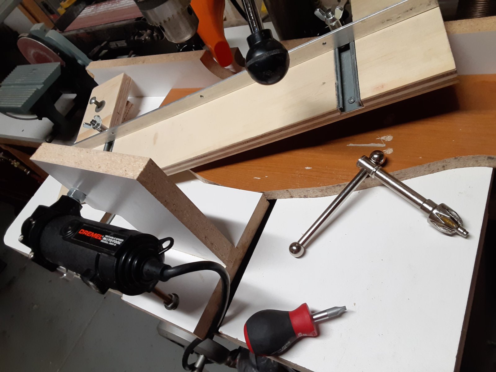

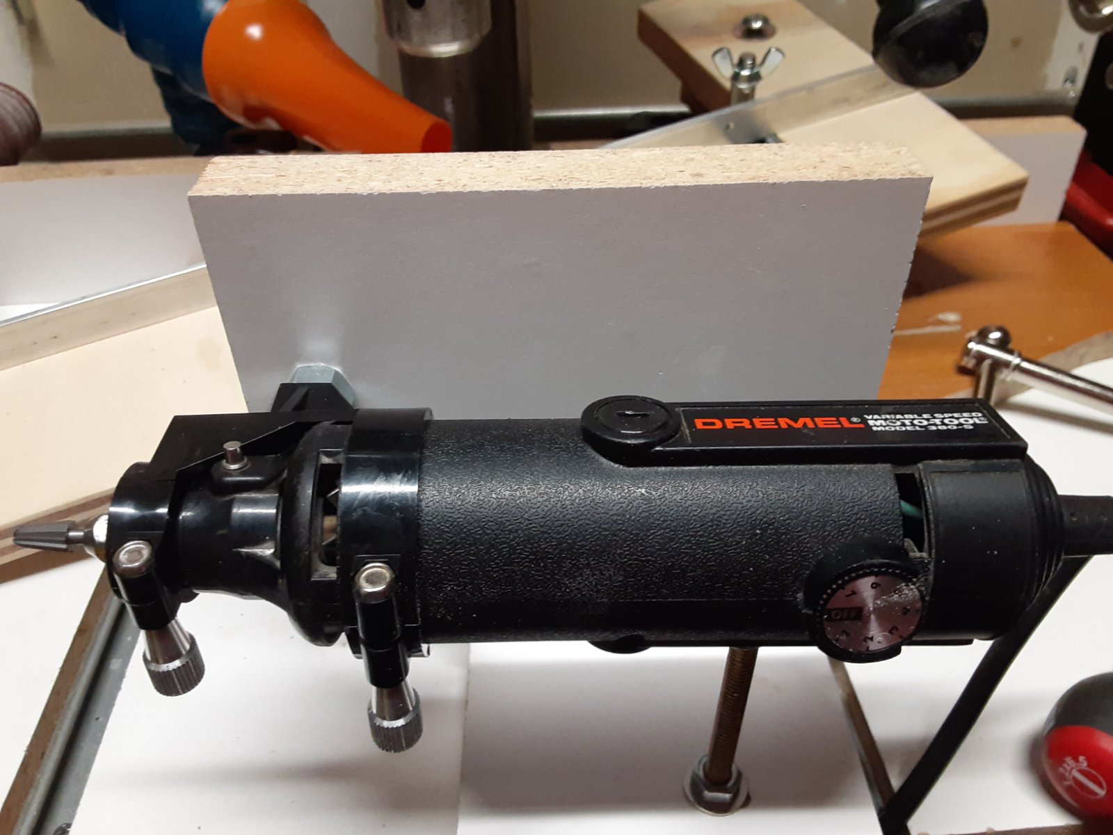

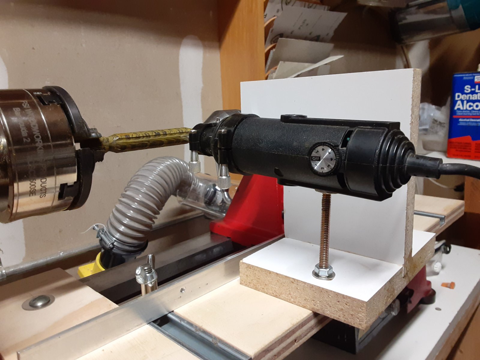

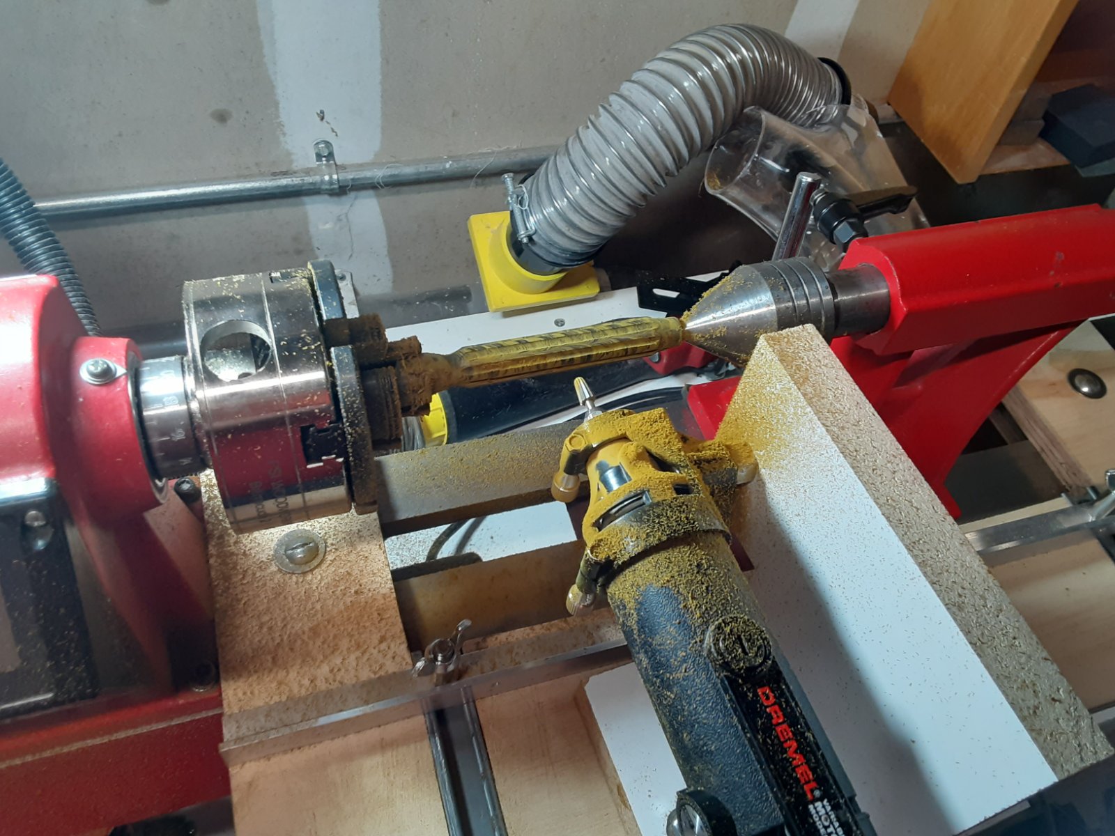

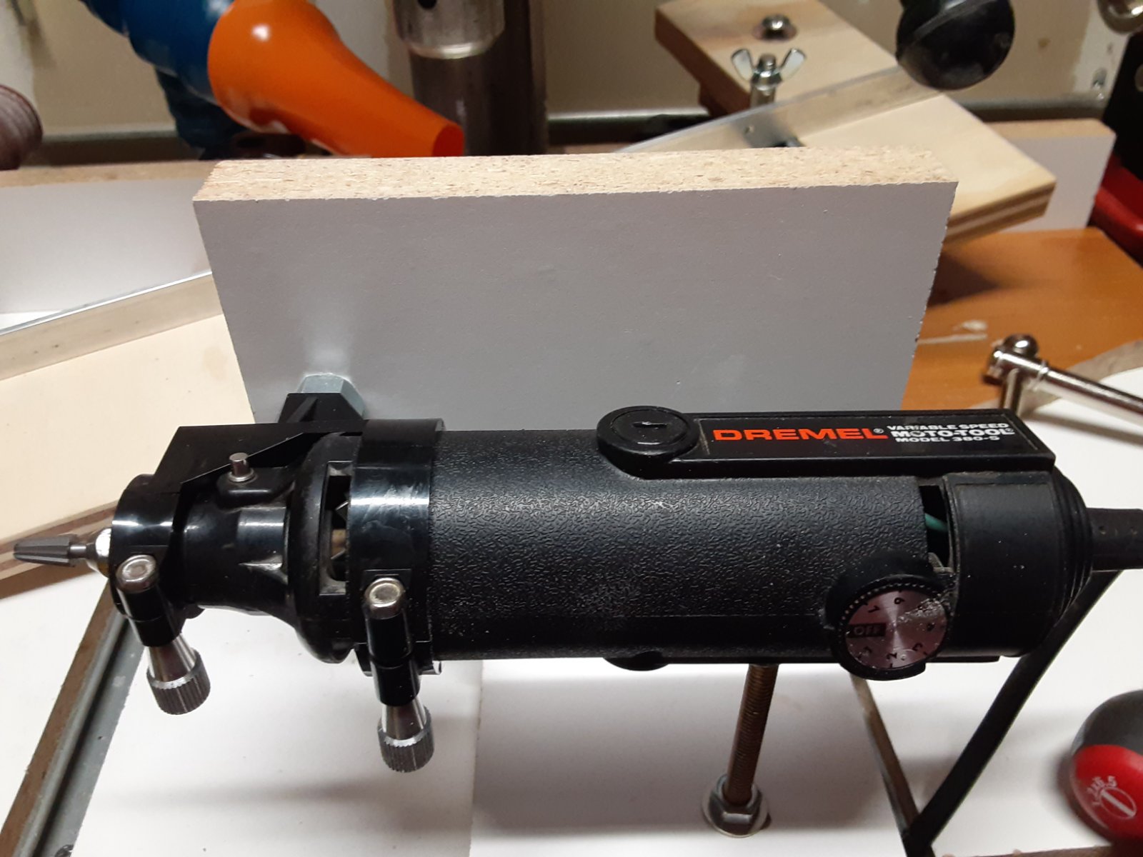

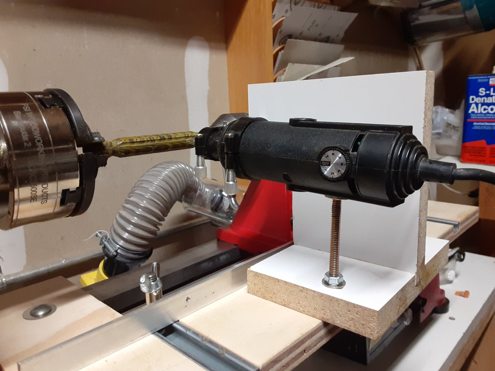

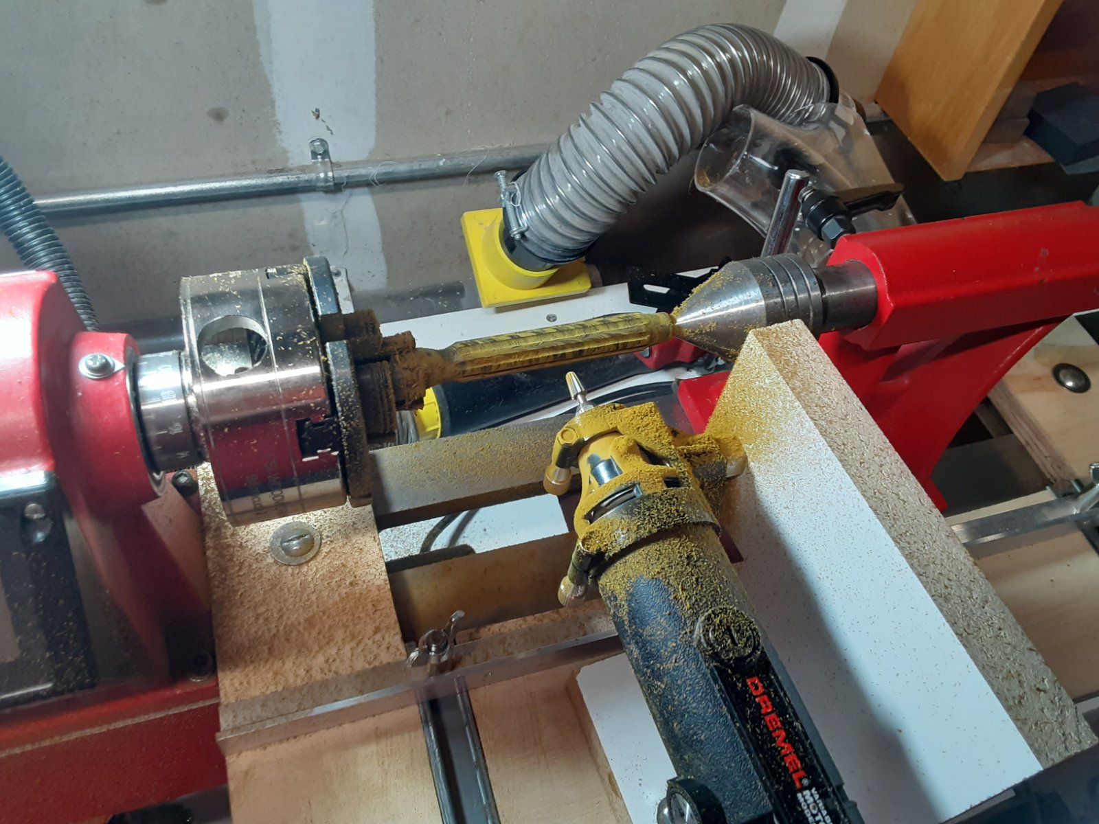

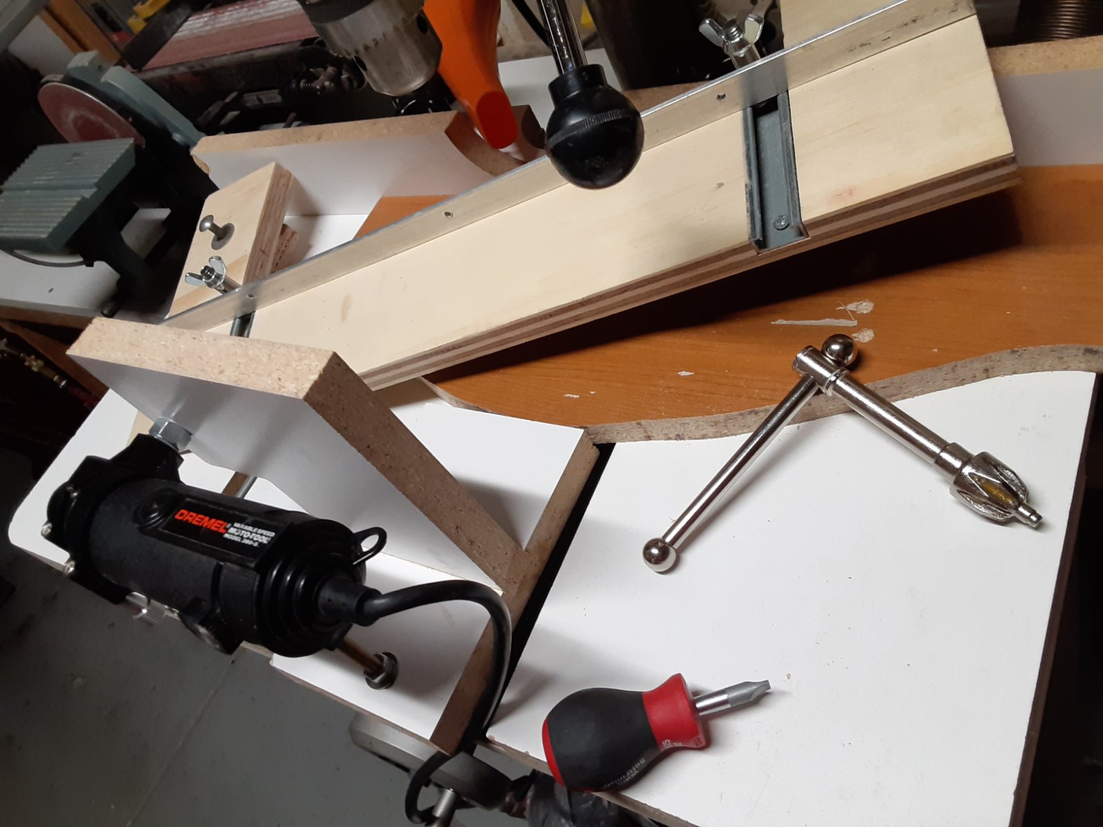

I used the indexing feature on the lathe to set the angle between facets. then I made a jig to hold a dremel moto-tool that moved on the bed way. I used it to cut hollows, but a different bit would allow you to cut facets.
