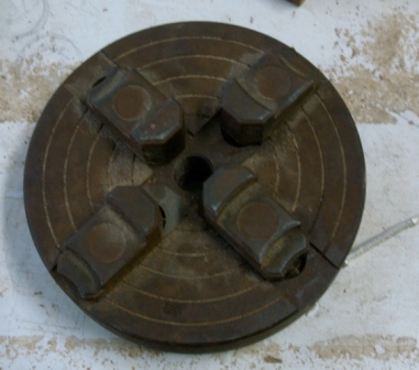

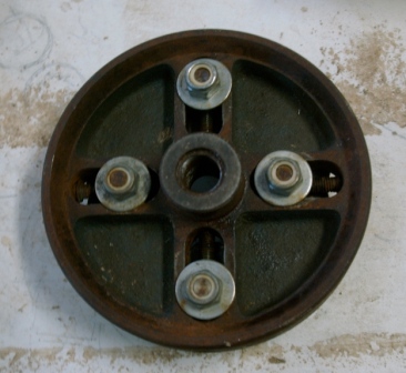

I have this chuck fits a 3/4 16 thread, I believe its off an old craftsman lathe I used to have. Yours for the cost of postage if you want it. Its to large to go small flat rate. First class would probably be cheaper than med flat rate. It takes a square drive key to adjust the jaws which I have I just didnt take a picture of it. Mike
