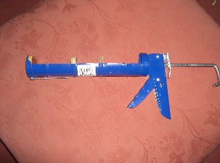

Hi All,
Further to my earlier post, I am now having no problems with cracking!
I took all the advice given, and they certainly have made a big difference.
I cannot take full credit, as whilst waiting for my pen press to arrive, I was walking around my local hardware store with my wife, and "she" was inspired!
(I would like to take credit for this, but she does sometimes read my posts so i'd beter play safe!)

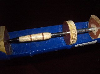

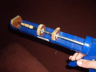

She asked the quetion why a silicon sealant gun wouldn't work to press the parts of a pen together????
As I didn't know, I decided to try it,,,,,and it works a dream! See photo's below!
If anyone can think of any drawbacks to using this, please let me know???

Kenny,
Can't say as I've thought of this one, but necessity IS the Mother of Invention. Seems to me that as long as you can keep everything lined up and apply steady pressure you've got a solution. Absolutely has to work better than the "beatin' tool". Stuff like this is why I keep coming back to this site. The ingenuity of the membership is terrific. Caulk away...
Rob
The only draw back I can see is There may be times when you will not have the "esactness" of control as in when the clutch engages into one of the "cogs"(?)
It may get some kind of a memory built in.
I used a quick grip clap till I wore it out which is the same principle you are using.Hey if it works go for it.

Like Eagle said, the tube gun may not give you the exactness you need especially on some pen kits where the mechanism must be pressed in a specific distance, such as slimlines. I would also second the use of an arbor press instead of a pen press. The arbor press may be had cheaper and can serve other functions around the shop other than just pressing pens together.

The sealant gun can make very fine adjustments to the pressing of parts, and I am currently using it on slimlines, checking on the mechanism insertion to ensure the correct depth is achieved.
That said, I am not sure if this will be a lasting answer! Wear and tear will be it's downfall.

Kenny, I like your idea of using a caulking gun as a pen press and had considered it myself once before I got too fancy.
I didn't use it because of the question of the latching mechanism being inexact as eagle and others said. That was before I'd seen the use of a block being used as a stop and as a measure for pen presses. I think this now deserves more consideration!
It may even work better than using a stop block with a regular pen press for getting consistent, same measures. The pressing mechanism here is a bit larger than a normal press and can be rigid enough that you can just drop the measuring block into the tube holder without having to hold the pen parts and block all together which can be quite a handful! As the pressure can be immediately released by turning the driving push rod around and the mechanism latching spacing is no longer a problem. This could be used vertically or horizontaly as space permits. It's just too bad that the handle assembly can't be turned to the side as well so you you could better face the open working area. This could still be a good and cheap solution for folks with a limited amount to invest. [;)]
