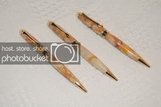

Millifiori mean thousand flowers and it refers to making canes of stacked clay and slicing them to make thin flowers or other creations. Here are some of mine as examples.

Oh and here is one of my mokume ganes. This one uses ink painted on top of layers of translucent clay with gold leaf. You can really do nice things with polymer clay
