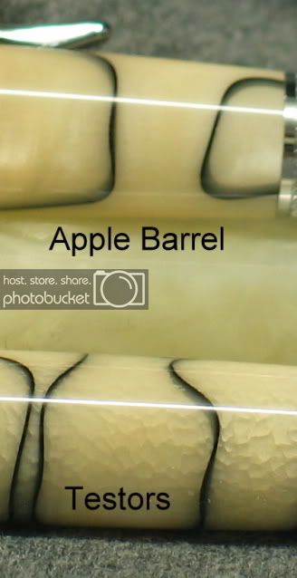

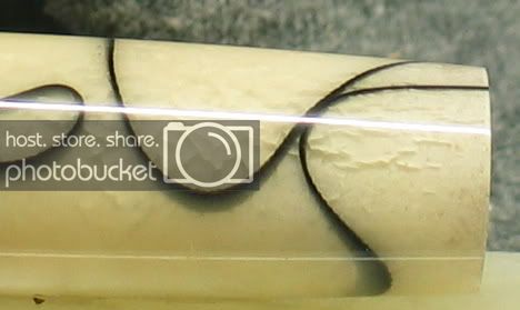

Crackled finish when painting blank interior?

I painted inside a blank using Model Master Acryl and had a crackled/alligator finish showing after turning the blank. Google search shows "alligator" effect is usually caused by applying the 2nd coat before the 1st coat dries. I let the 1st coat dry overnight before the 2nd and no problems with other colors done the same way but this one sure went wrong. Anyone else have this problem and know of a different cause/way to prevent? I'll try another bottle of paint and let it dry 2 days next time but asking the question in case there may be another cause. Thanks in advance!
Edit to add: I used 5 minute epoxy tinted with Mixol white as the tube adhesive (again, similar to other blanks but I don't always tint the epoxy).

And yes -- actually had the problem on all 3 blanks (both blanks of a workshop pencil and this Sierra blank).

To close this one...
I tried a different bottle of Testor's and cleaned the blank and still had the crackled interior finish. I switched to Apple Barrel brand acrylic paint for the blank interior and no problem. I've used other Testor colors and the white with other blanks without problems but for whatever reason the Testors didn't work well with the Mica Swirl AA blanks. The Apple Barrel is cheaper so at least something positive with this project.

I can be too heavy handed sanding or polishing but after the 1st occurrence, I tried to dial it down. I also examined this last problem blank before I started sanding (just after the skew) and still saw the crackling.
