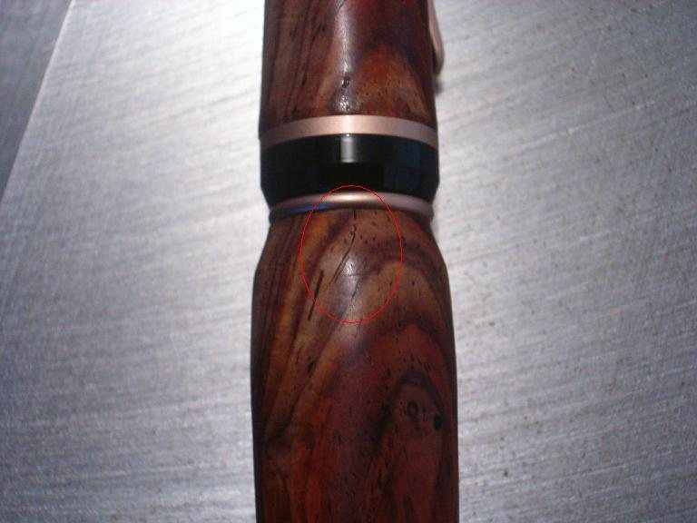

I made one of my nicest cigar pens yet, in my opinion today. It has been finised for a few hours, and I just noticed that there is a small SMALL crack in the edge near the center on the bottom half. The pen is assembled and I have a buyer. Is there anything I can do to fix this. My thought was to drill a SMALL hole at the end of the crack and finish with CA.

I will have to send the picture when I get home. I have the pen with me - but no camera.

Sorry it's Cocobolo - I'm going to go take a picture of the crack right now.

There is another pic in my photo album.

Unfortunately, that is a not a good spot for a crack. That was definately caused during the press fit process. Maybe from either a component that was made to tight, or more likely from soem CA or other glue in the tube. Also, could have been from a poorly milled blank where that portion extended slighly past the tube edge. The problem now, is that is are is likely under pressure. To save this one, I would simply dissassemble, put back on the lathe and fill with some thin CA. Then you can use your same finish. For a stronger repair, that would not be visible at all, I would use a CA finish over it.
