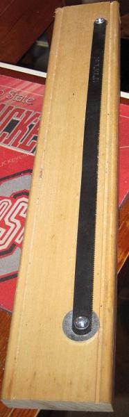

I buy my sandpaper in sheets, so here are two tips that may or may not be helpful for you.
Tip #1: Make one of these. Nothing more than a hacksaw blade that I had bent, and thus was no longer useful in the hacksaw. It's screwed to a piece of scrap poplar with a washer under one end. I use this to cut my sandpaper into smaller strips. The paper goes in the jig face down, and you just pull up against the blade and it cuts the paper like butter, no dulling of a razor blade, or any other sharp blades to cut with.

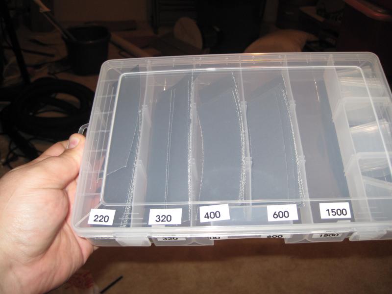

Tip #2: I store the cut strips of sandpaper in a storage box. This particular one came from HF. They are currently having a sale on them for around $2 and some change.

I made a sandpaper "cutter" similar to this about 20 years ago after seeing it in a magazine. The one I have has a washer at both ends to make it easier to slip thicker sheets under it. I also used a larger (not as easy to store as this one) sheet of wood, but I put lines on it so that I would know where I wanted to make cuts. I suppose you could mark it off like a paper cutter, but I just did a couple of lines for my normal sizes. I am still on my original blade. It is a great idea and works really slick.

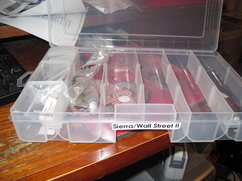

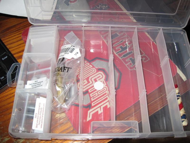

Here is how I handle the pen kits/bushings
Another of the same container for the sandpaper, but on the left hand side I have it spit up so JohnnyCNC steel and delrin bushings on the left, and pen kits in the other 5 trays to the right. I find I can fit about 20 kits in a box at a time. That's more than I'll ever need IMHO at one time.
