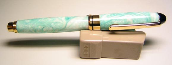

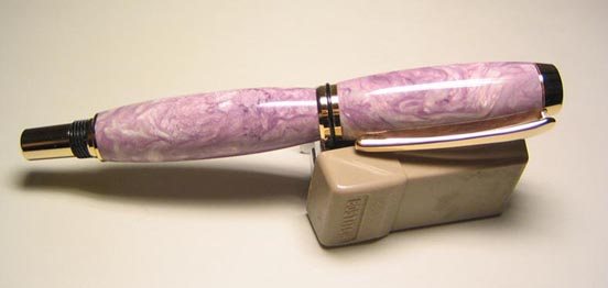

Well, this is the result of my first batch of resin castings. I tried for more of a twist with the colors instead of a complete blend. Since I'm new to the forum I figured I would show you guys what I've been working on.
So, from the experts, how am I doing?
Thanks for viewing,
John
Thanks for the replys guys. The colors I used were the green and purple liquid dye. I bought a wide arrangement of dyes and pigments to try. I'm really happy with the liquid dyes. I followed Yoyospin's lead on adding the dye last after the luster pigment and catalyst had been added. I didn't wait for it to totally jell before adding the dye, but I did let it sit for a few minutes. Both of these pens have a nice twist affect with the luster pigment that I really liked. I tried a couple after these with adding the dye earlier and found that I didn't get the color contrast I was looking for.
