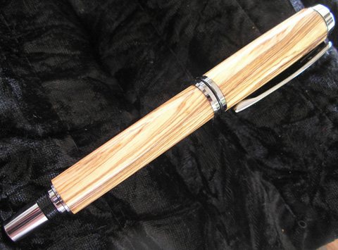

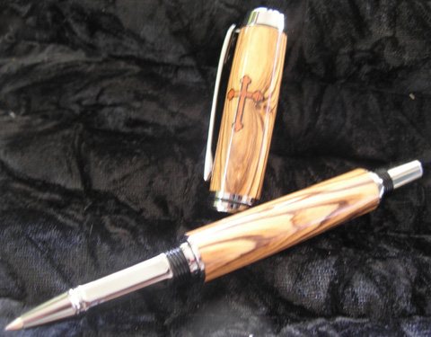

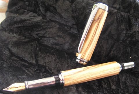

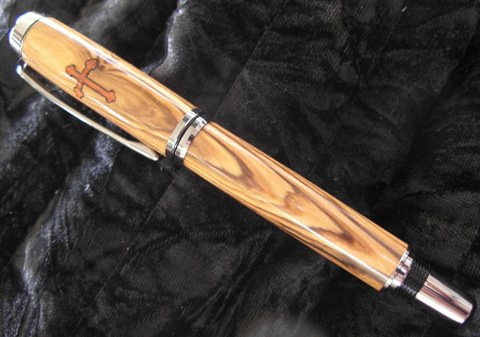

These are two Olivewood Barons I've been working on. The first is one of Ron Mc's cross blanks. The second is just some olivewood I had here. Both have some beautiful grain running through them. Both are done in Black Titanium which I think(IMHO) is the only plating to use with BOW. I apologize for the pictures, I tried taking em outside with natural light, very indirect, but still got way too much as witnessed by the washed out areas. Comments as well as photo help are welcomed!

Well done. Inlays or laser engraving is the only way to go with a Baron, at least with Ti plating. I tried having a cross afixed the the clip of a Baron without success. Ended up similar treatment to yours after laser engraving.

Skye, I don't have a clue what you're talking about and I don't think you do either! As is often the case when taking pictures there is an illusion created by reflection of the dark background and it makes it appear that the trim rings are much, much smaller than they actually are. I assured you both pens are turned and mic'd to the exact size of the bushings!

I am pretty sure he is talking about the second to last picture. The silver parts are picking up the black from you backdrop and makes it looks like your bottom is missized.
Vick's right. If you paste the photos into a good photo editing software package and blow them up, you can see how accurate your fit is, Mick...or is that Connie? [8D]

Maybe Paint shop pro 9 is not a good enough photo editing software package because when I blow those images up above 200% the picture becomes too grainy to see anything about how well the fit is.
If I read the post correctly it did say "Comments as well as photo help are welcomed!"
To me, it does appear in the second to last picture that the wood and trim ring do not match but seeing that you went ballastic on Skye for mentioning this I'll just say "Nice Pen, Good Job"
Grain alignment looks good. I like the black titanium on this one. Photo hints. If you are shooting a black titanium pen, use any color OTHER THAN BLACK for the backdrop. It eats up the detail on the hardware. Get some pvc and make a light diffuser. That will get rid of the burned out areas from too much light. Go to any photography store and buy the graduated shade backdrops. I believe they come in 11x17 sheets in many colors. If you can, reduce your f-stop to increase the depth of field or else have the pen parallel to the camera lens. That will get rid of out of focus areas.

Very nice pens. I just love the cross pens. I still haven't finished a baron and I'm going to have a week to play soon, so I think I'll try one again. I blew out my first one. BTW, if you're looking for me, I'm in the business section.
