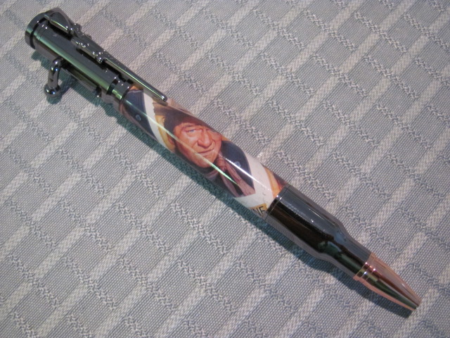

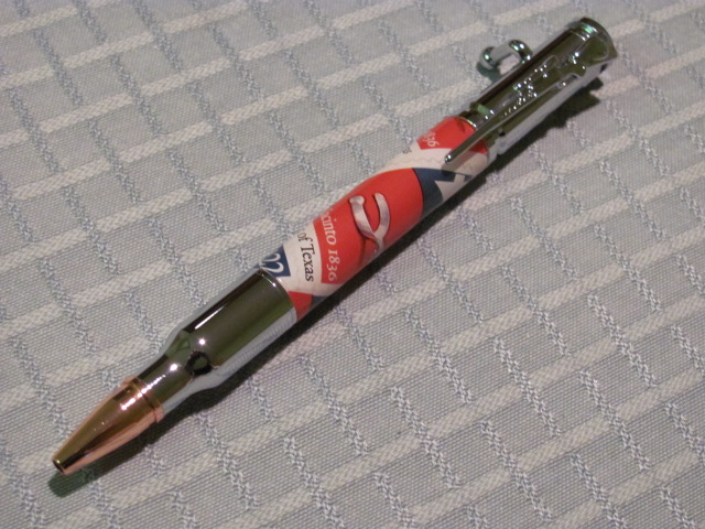

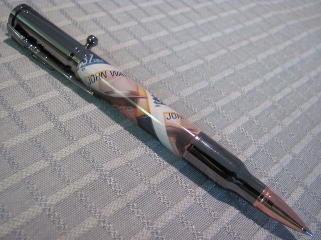

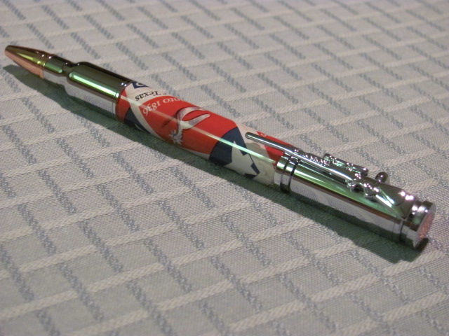

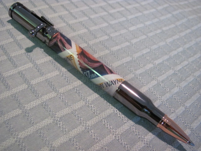

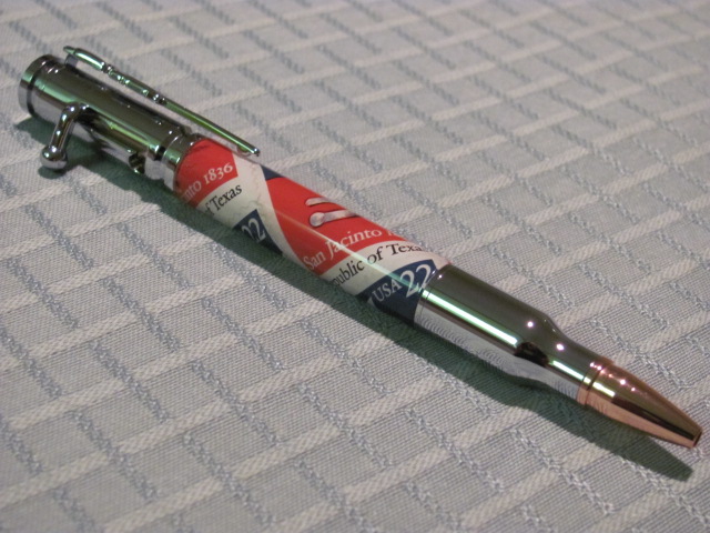

Hi all,
Here's how my 2 bolt-action stamp pens turned out.I thought it would be neat to make one in honor of John Wayne,great American & one to pay tribute to the great state of Texas.
I used USA John Wayne stamps,and the Republic of Texas stamps.Sent in to have cast by Don Vann,who did a nice job on them.( Thanks Don!)
I know that they are supposed to be made with camo,antler or gun-type wood on them,and except for the antler I have done all these,but I wanted to do these for a long time,something different.
I had a third,using the neat looking Texas Statehood stamps,but it got wrecked.Gotta try that one again,it looked cool!
Thanks,
Steve
