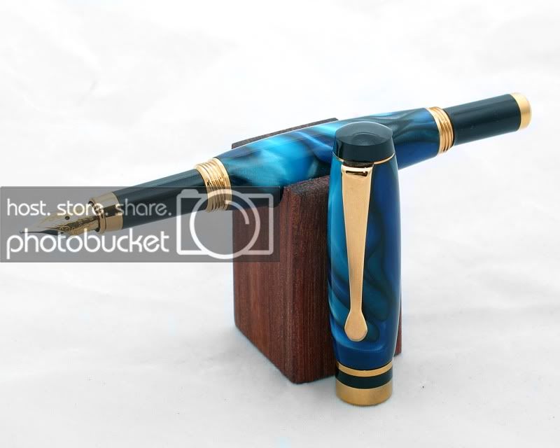

I had some Woodcraft credit and their fountain pen selection was limited so I ended up with a kit I'd never turned before. It's an American Classic Gold Fountain. Feels too light to me, but I prefer some heft to my pens. Like it all the same.

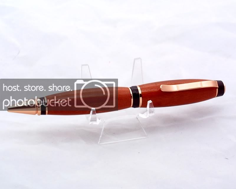

Second is just a basic Copper Cigar in a wood called Massaranduba. It's an African wood, but that's all I know. It came in a bulk Ebay box. It has some very beautiful waterfall figure, but it doesn't translate in the picture.
