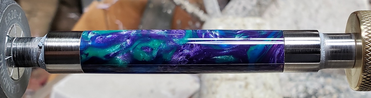

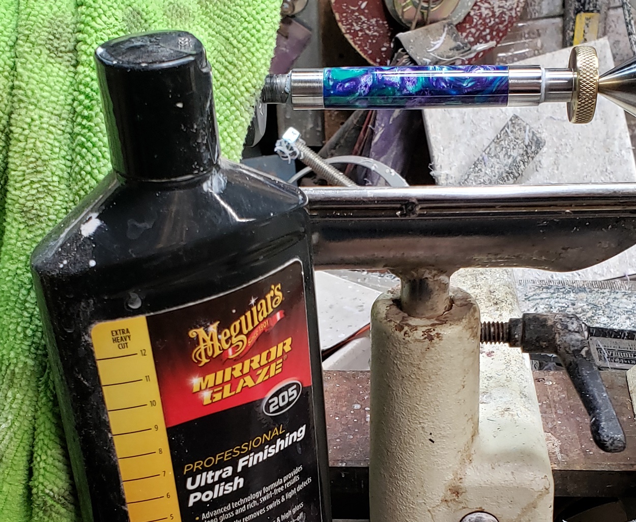

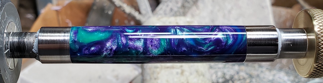

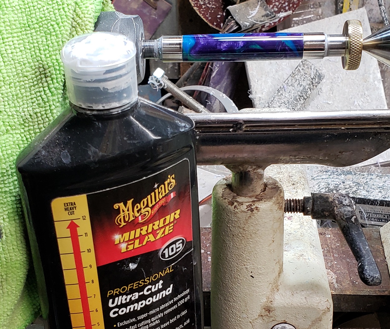

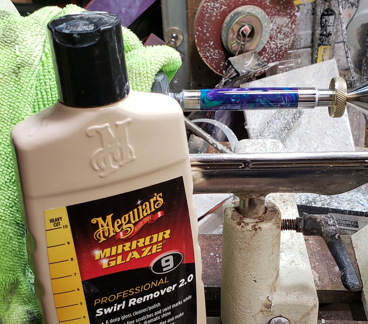

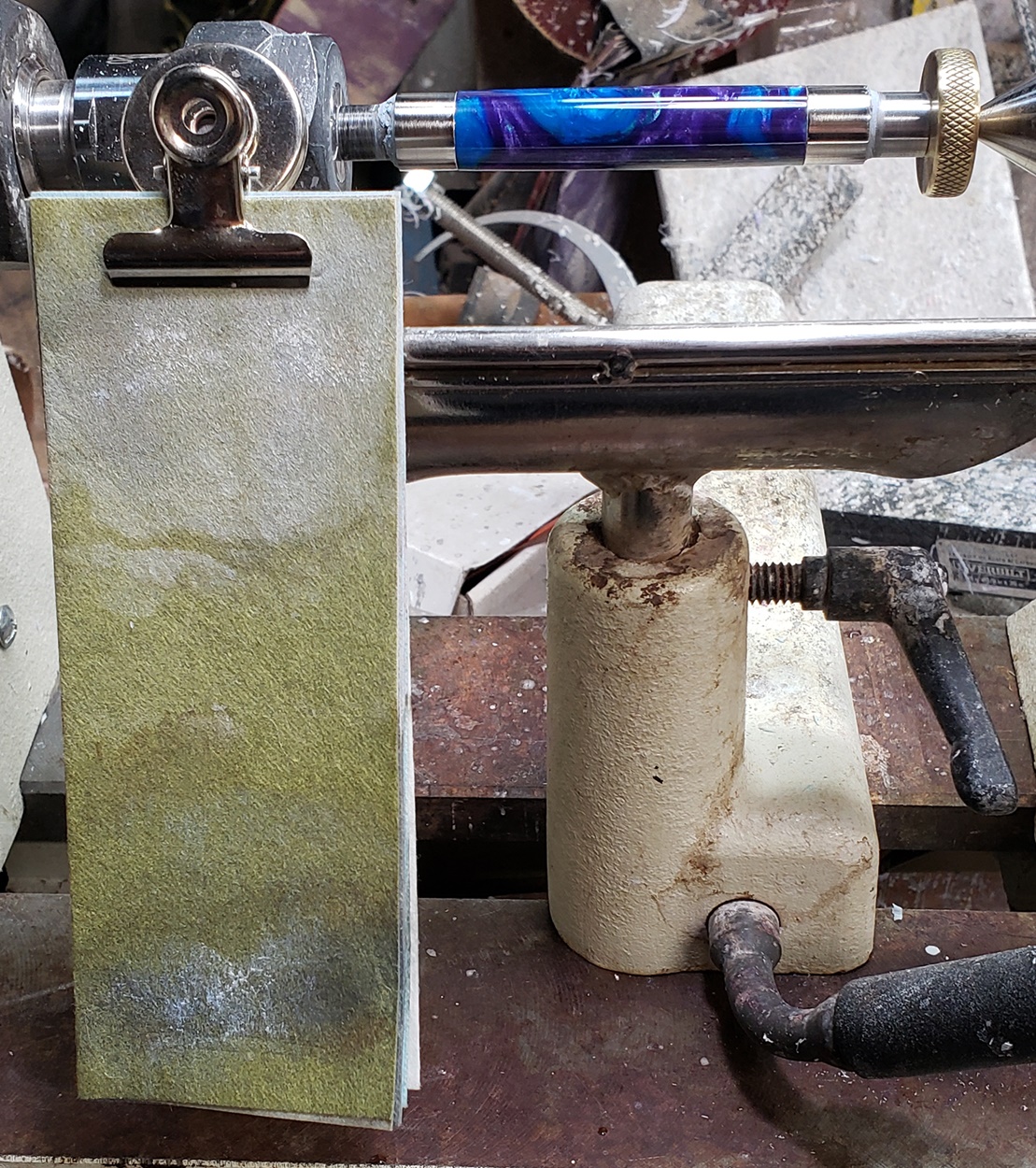

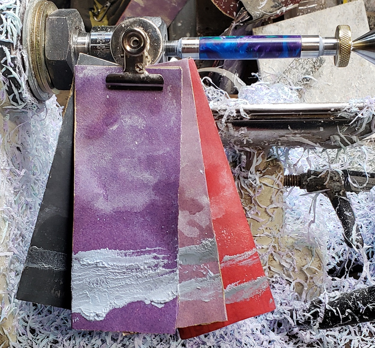

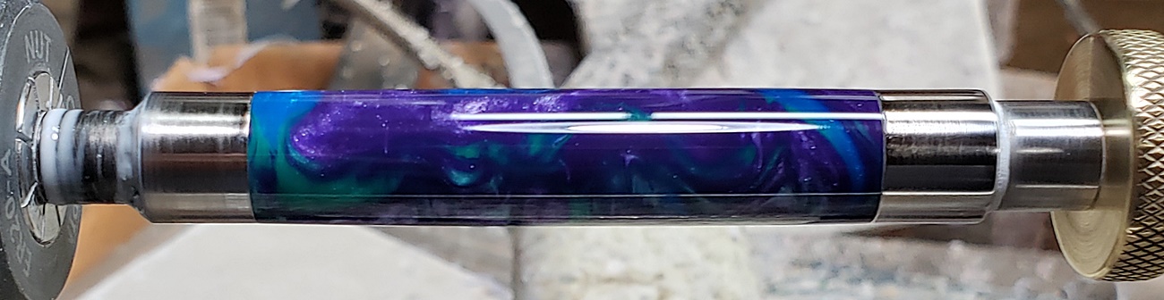

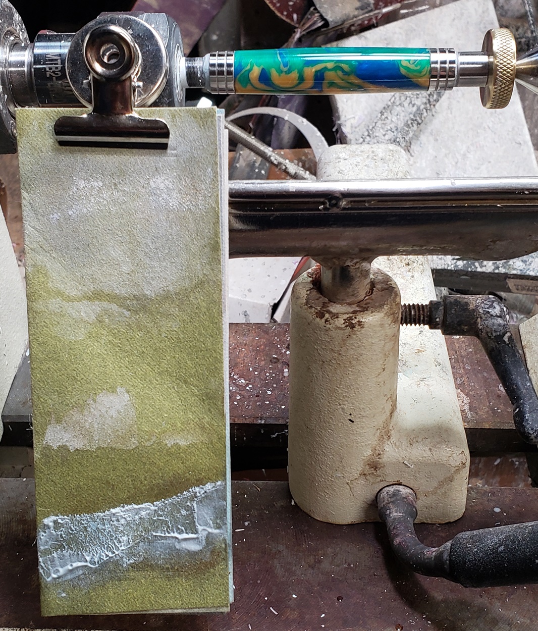

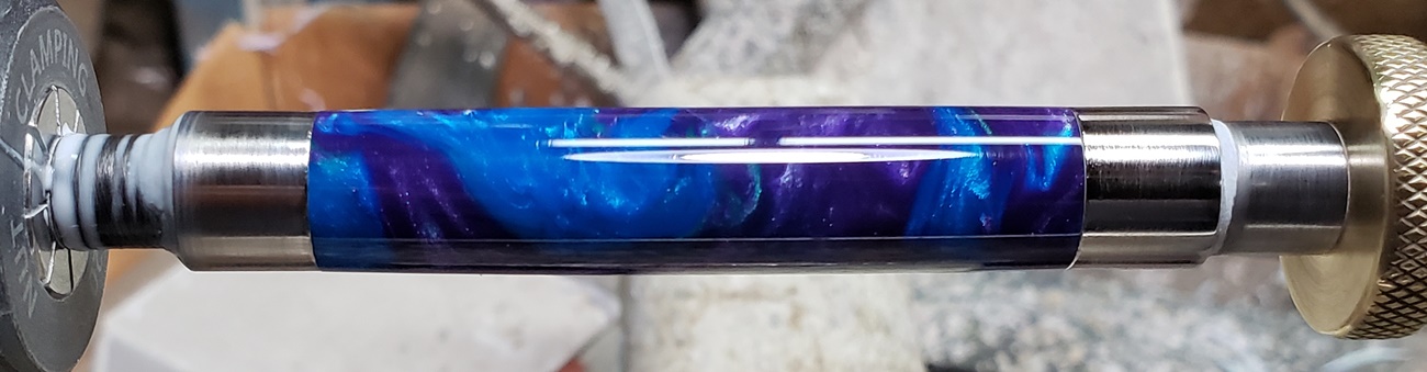

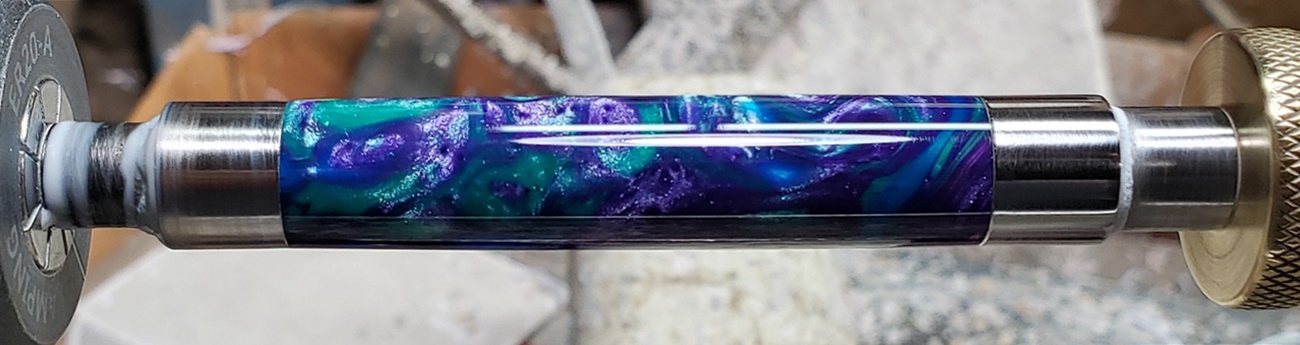

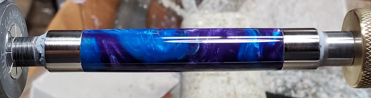

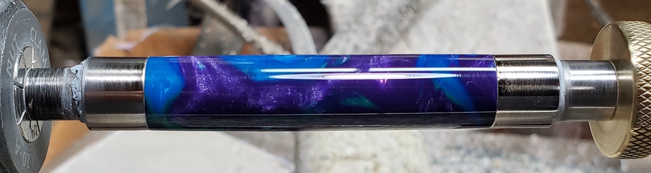

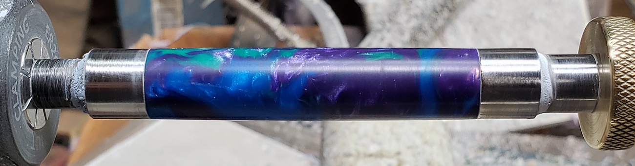

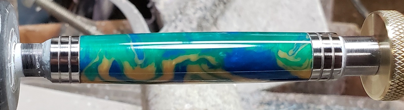

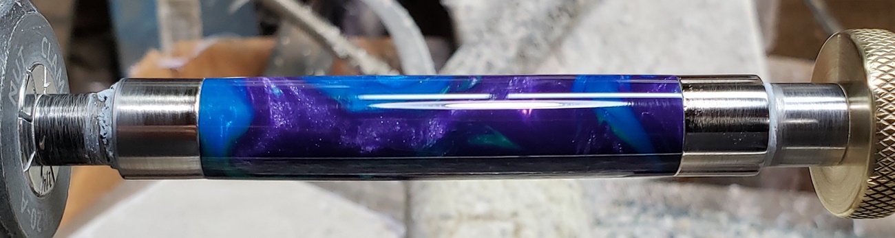

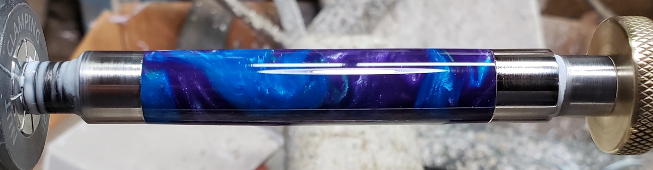

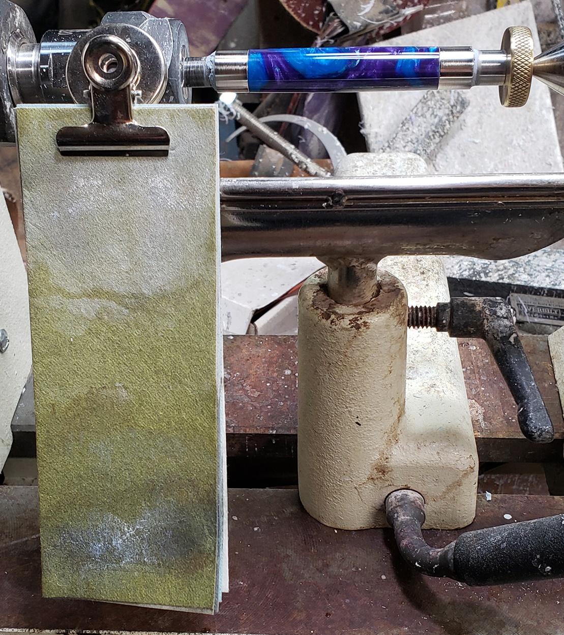

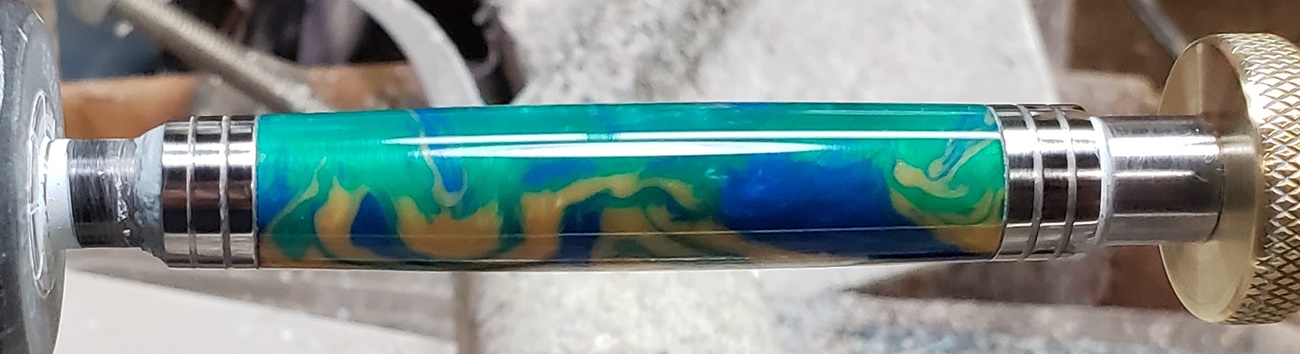

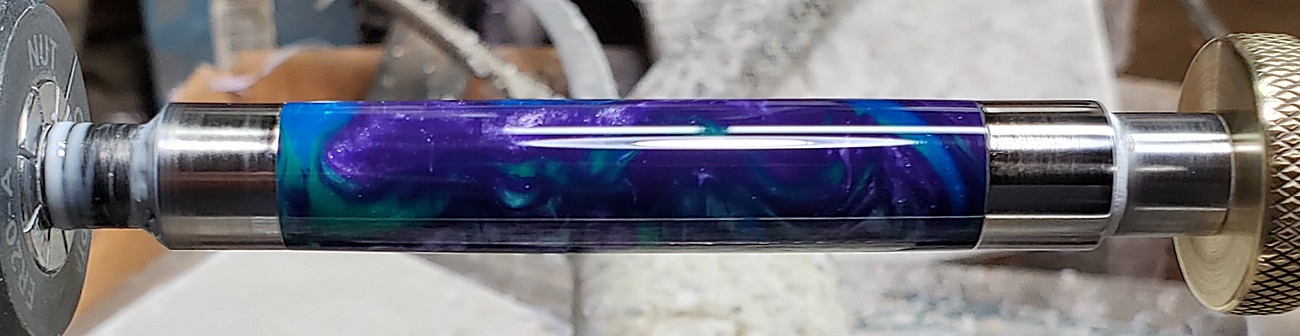

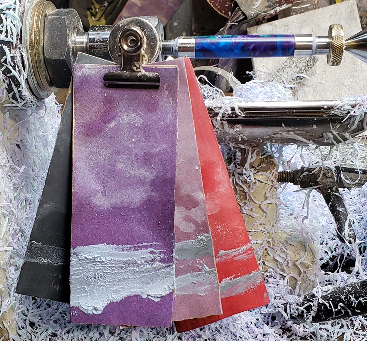

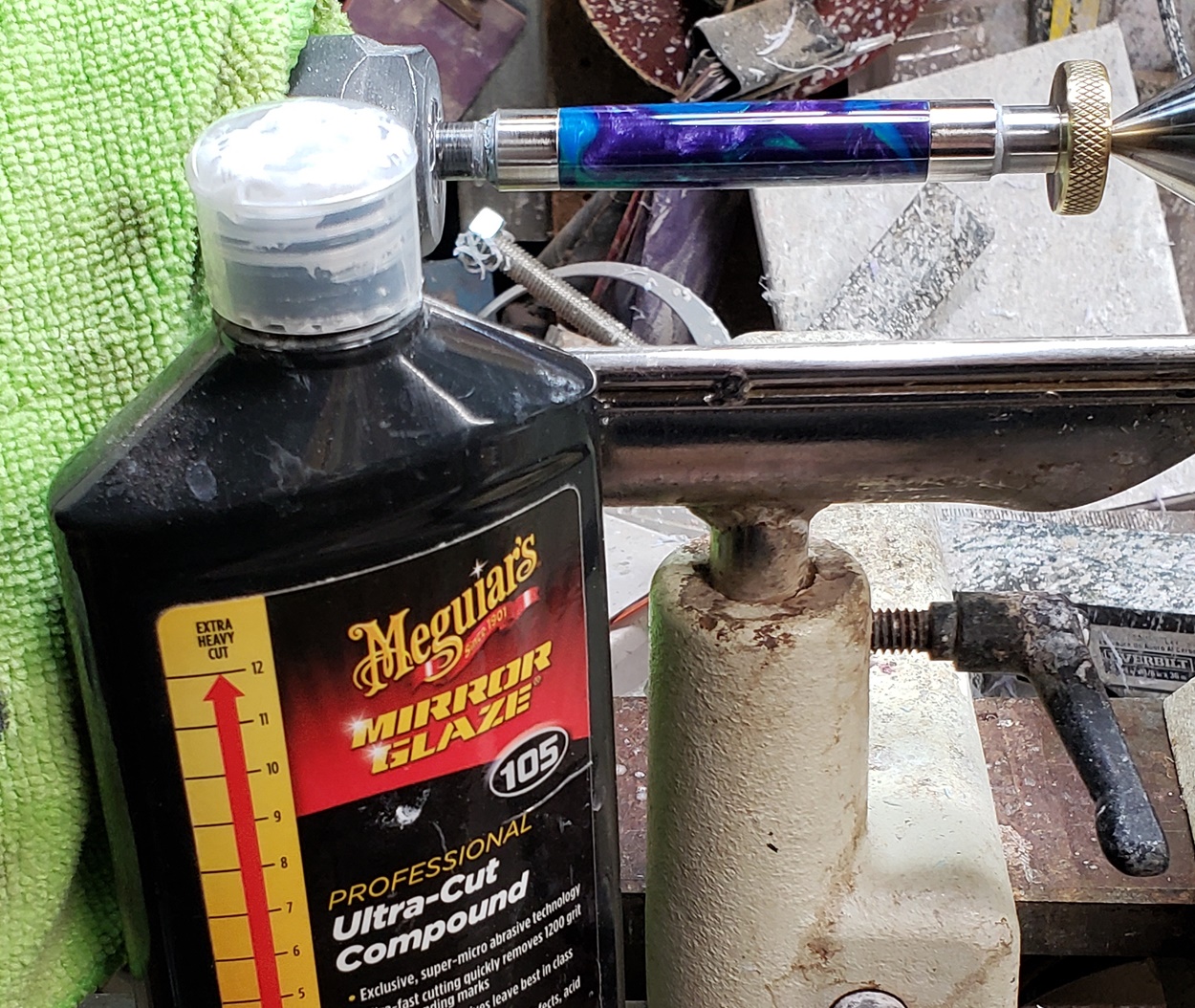

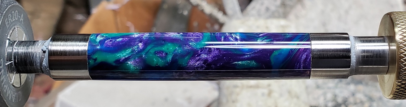

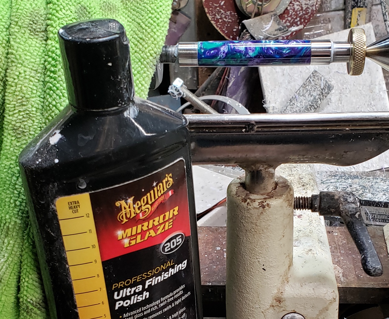

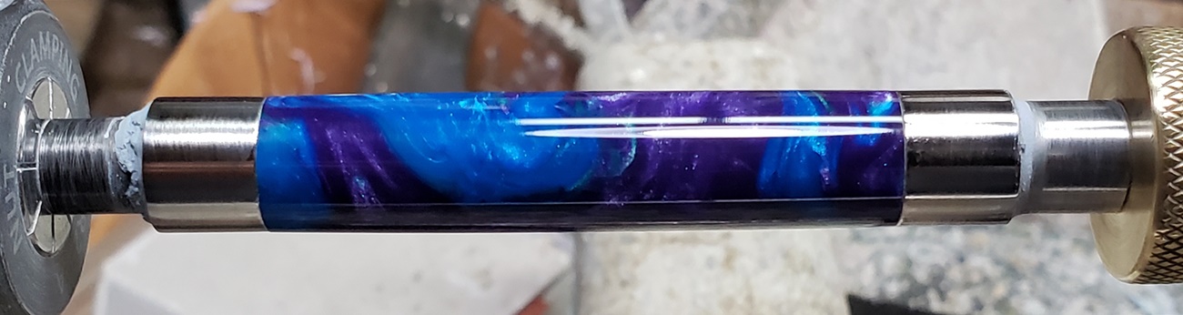

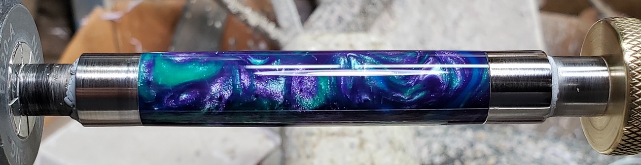

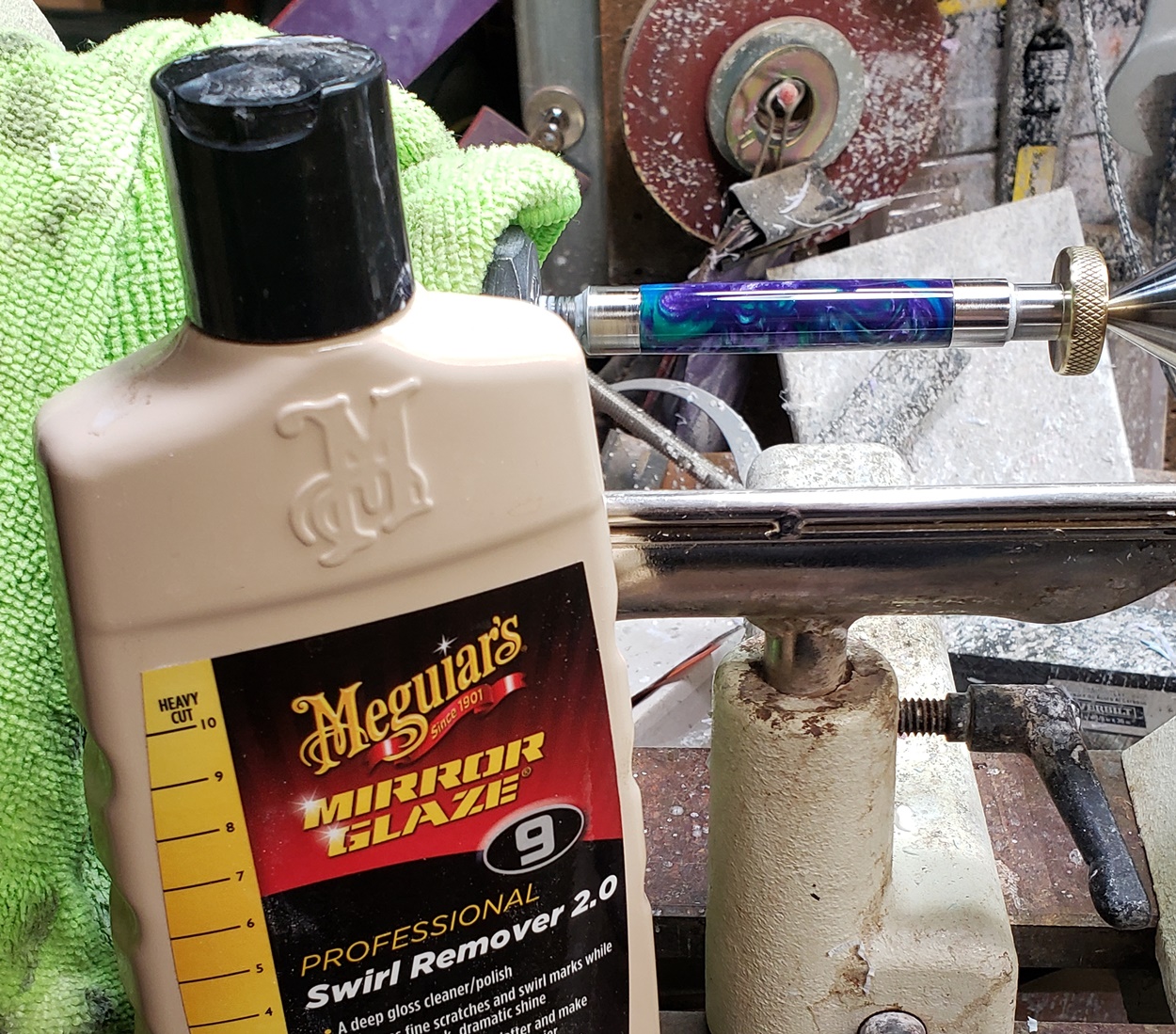

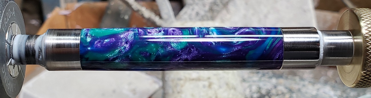

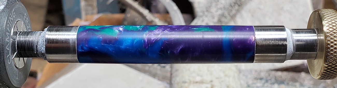

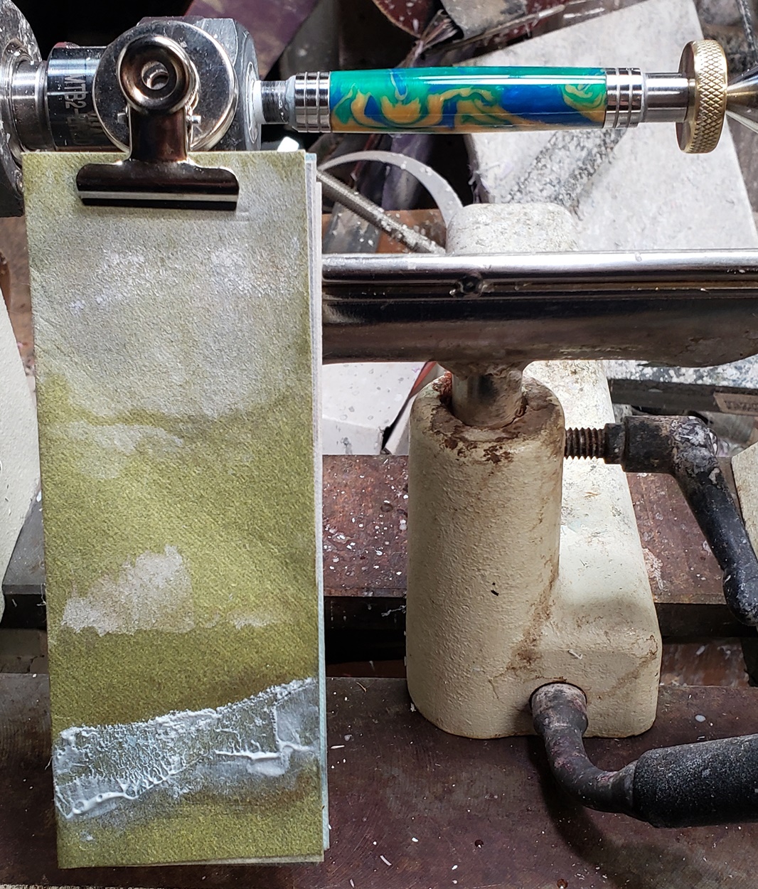

I just finished this one using Zona. I wet sanded with 220-600 grits, used all six grades of the Zona, then followed up with Meguiar's 105, 205, and #9. In person, I can see a slight improvement between the Zona and Meguiar's. But I still can't tell if there's a difference between Meguiar's 205 and #9. This is an inlace acrylester blank called Peacock.

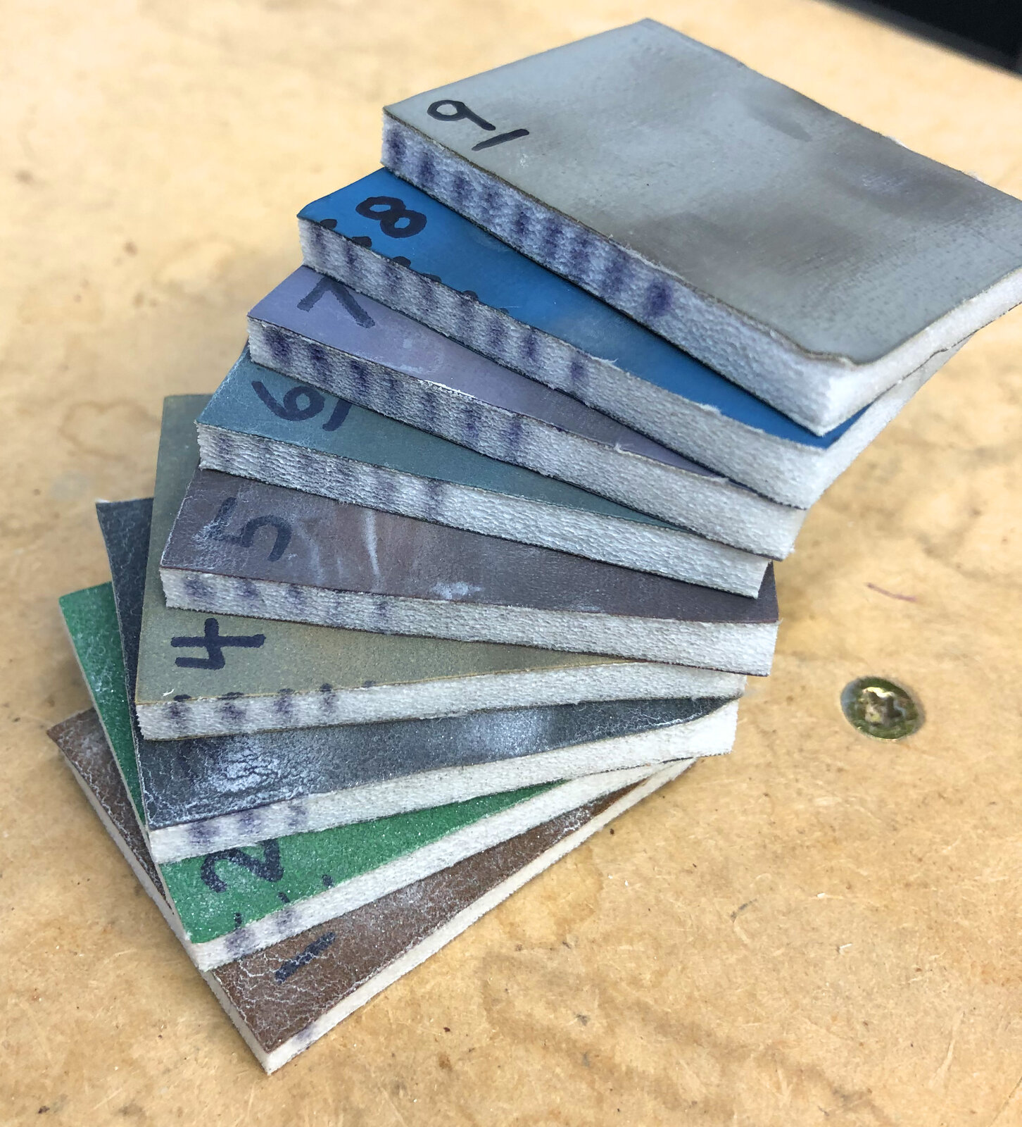

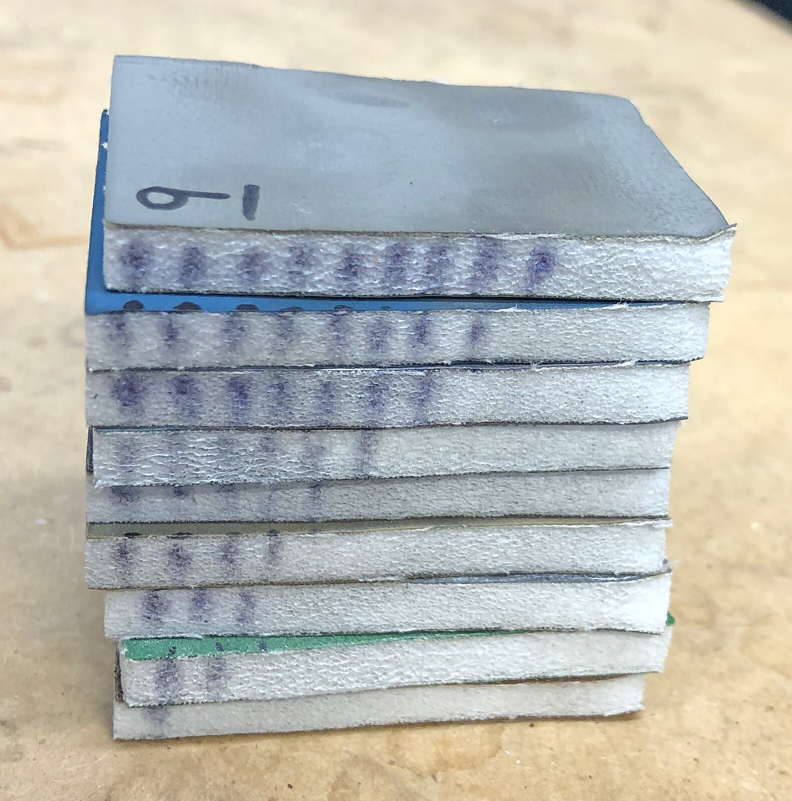

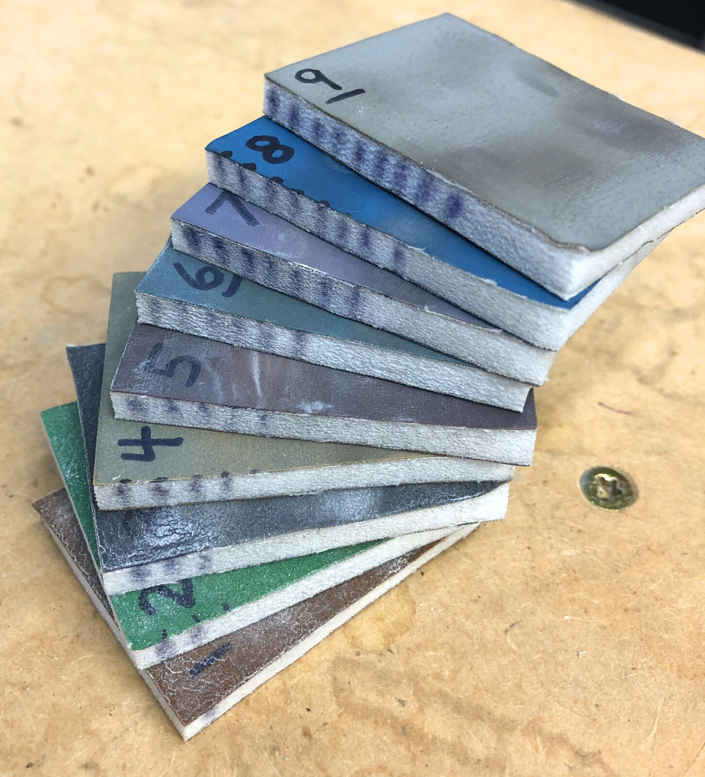

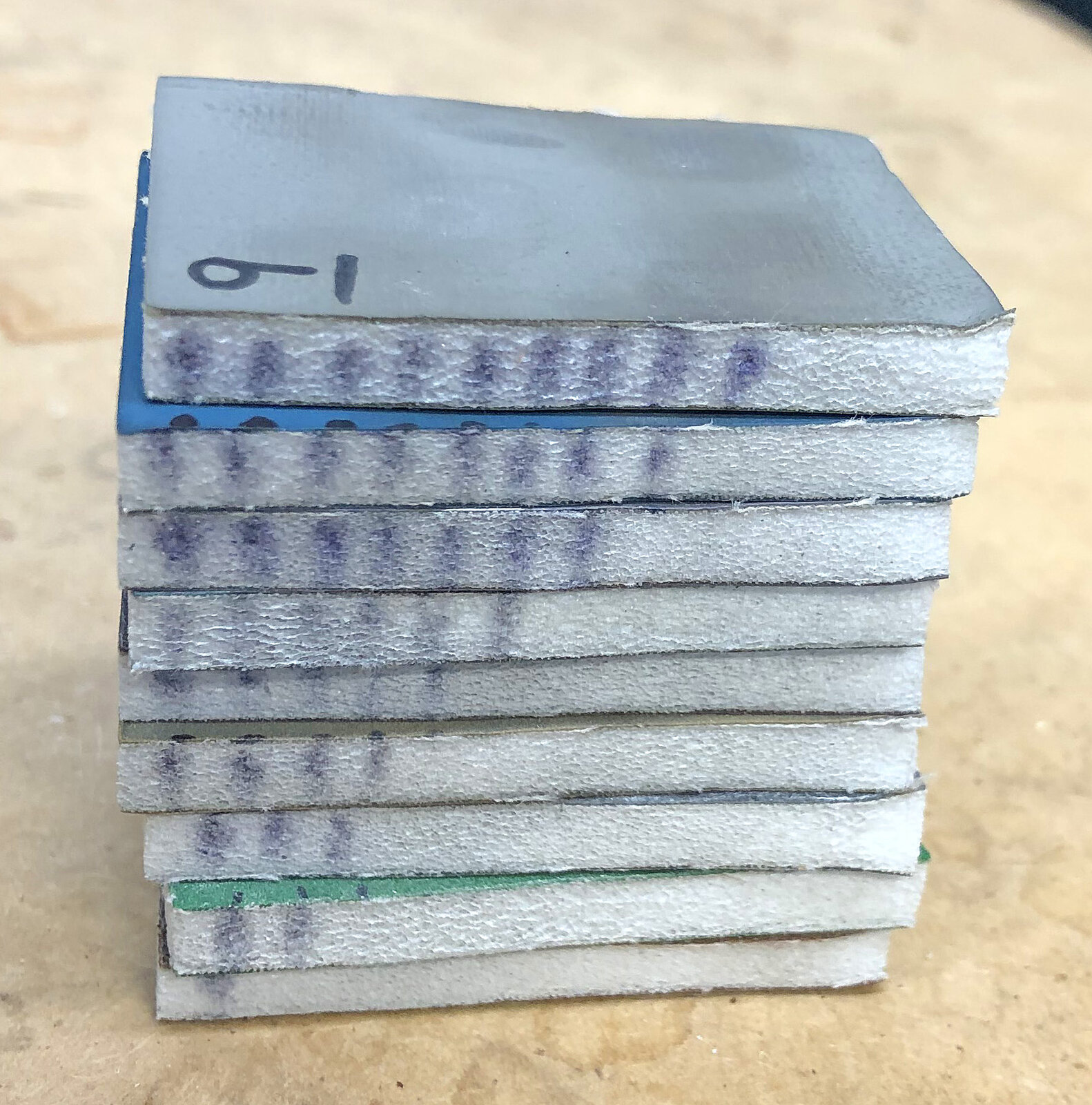

I use the Micro-mesh pads. Like others, I buy the 3x4 inch set of nine pads and then cut them into smaller working pieces.
I use Micro-mesh on CA finishes. I keep them wet in a plastic cup of water while finishing. I let them dry out for storage. If you use them only for finishing, they last a very long time. You can do many many pens with the same set. I have yet to wear a set out, but I have lost a couple sets by leaving them behind at other sites (demos, etc.).
-> I mark the sides with separate dots using a Sharpie. The first pad gets 1 dot and the last pad gets 9 separate dots.
(I tried other marking techniques like writing the numbers or making a "V". The numbers were too fuzzy to read, and the "V" put two dots on each pad that were harder to read to get the sequence right. That's especially true if you put a "V" on both sides for convenience - the two sides won't match, and figuring out which side is which, or which face is "up" on a given pad doesn't work well.)

I wet sand with MicroMesh pads and they seem to last a long, long time for me (on the order of 50 or so pens). But, as for the Cost Efficient part of your question, the little 2 x 2 inch MicroMesh pads from PSI for example run $27 for the set of 9 grits. I however, bought mine from Chad Schimmel over at Turners Warehouse, they were called Micro Polish Pads and were $12 for a 3 x 4 inch set. I cut them into quarters giving me essentially 4 sets of 1.5 x 2 inch pads, so each set works out to $3 -- yes, they are a little smaller and don't have rounded edges but they are a lot more cost effective compared to MicroMesh from PSI.
I think the color code is a little different than MicroMesh, but I use a Sharpie permanent marker and number each pad in the corner. So far the numbers remain legible even through wet sanding sessions.
I started out using your dots method (well, maybe dashes), but I also found that I could simply write the number on the surface of the pad and so far it seems to hold up just fine for me. - Dave
Great tip. I hope others can use it.
Speaking only for myself, I prefer not to write on the abrasive surface. I can cite no good reason to back it up, other than not wanting to risk transferring any old ink to the workpiece (pen), no matter how unlikely it is.
