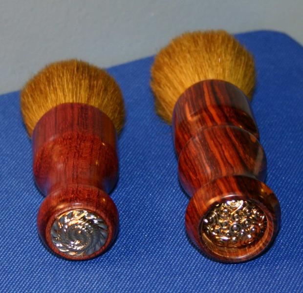

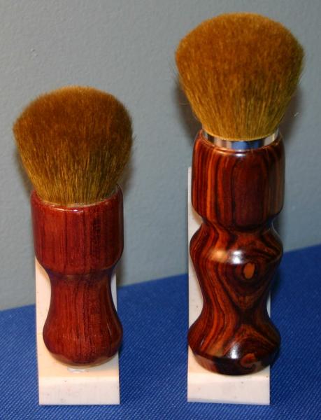

THarvey Member Joined Oct 4, 2007 Messages 2,087 Location Anniston, AL, USA Jan 7, 2009 #1 Cosmetic Brushes for Mother and Mother-in-law. Both have January birthdays. Shorter brush is bubinga. Tall brush is cocobolo. Sable brushes from AS. Thanks for lookings. Comments welcome. Tim Attachments Mothers Brushes - 1.jpg 35.1 KB · Views: 173 Mothers Brushes - 2.jpg 58.3 KB · Views: 211
hilltopper46 Member Joined Jun 28, 2006 Messages 2,420 Location East Troy, Wisconsin, USA. Jan 7, 2009 #2 Beautiful brushes. What's in the ends of the handles?
PapaTim Member Joined Dec 24, 2008 Messages 449 Location Gainesboro, TN Jan 7, 2009 #3 Someone knows how to make the women in his life happy. Nice work.
THarvey Member Joined Oct 4, 2007 Messages 2,087 Location Anniston, AL, USA Jan 7, 2009 #4 hilltopper46 said: Beautiful brushes. What's in the ends of the handles? Click to expand... These are buttons. Had to drill a small relief in the center for the thread loop on the button. I have also used coins and stone.

F FireMedic4Christ Member Joined Mar 15, 2004 Messages 146 Location Parker, CO, USA. Jan 10, 2009 #11 What size drill bit did you use to hollow out the brush end?
THarvey Member Joined Oct 4, 2007 Messages 2,087 Location Anniston, AL, USA Jan 10, 2009 #12 FireMedic4Christ said: What size drill bit did you use to hollow out the brush end? Click to expand... For these I use a 1" forestner bit, then my skew to increase the diameter slightly. Ed Davidson (YoYoSpin) has a video on AS website. http://www.arizonasilhouette.com/Cosmetic_Brushes.htm The video is for EPR blanks, but the principle is the same. Last edited: Jan 10, 2009
