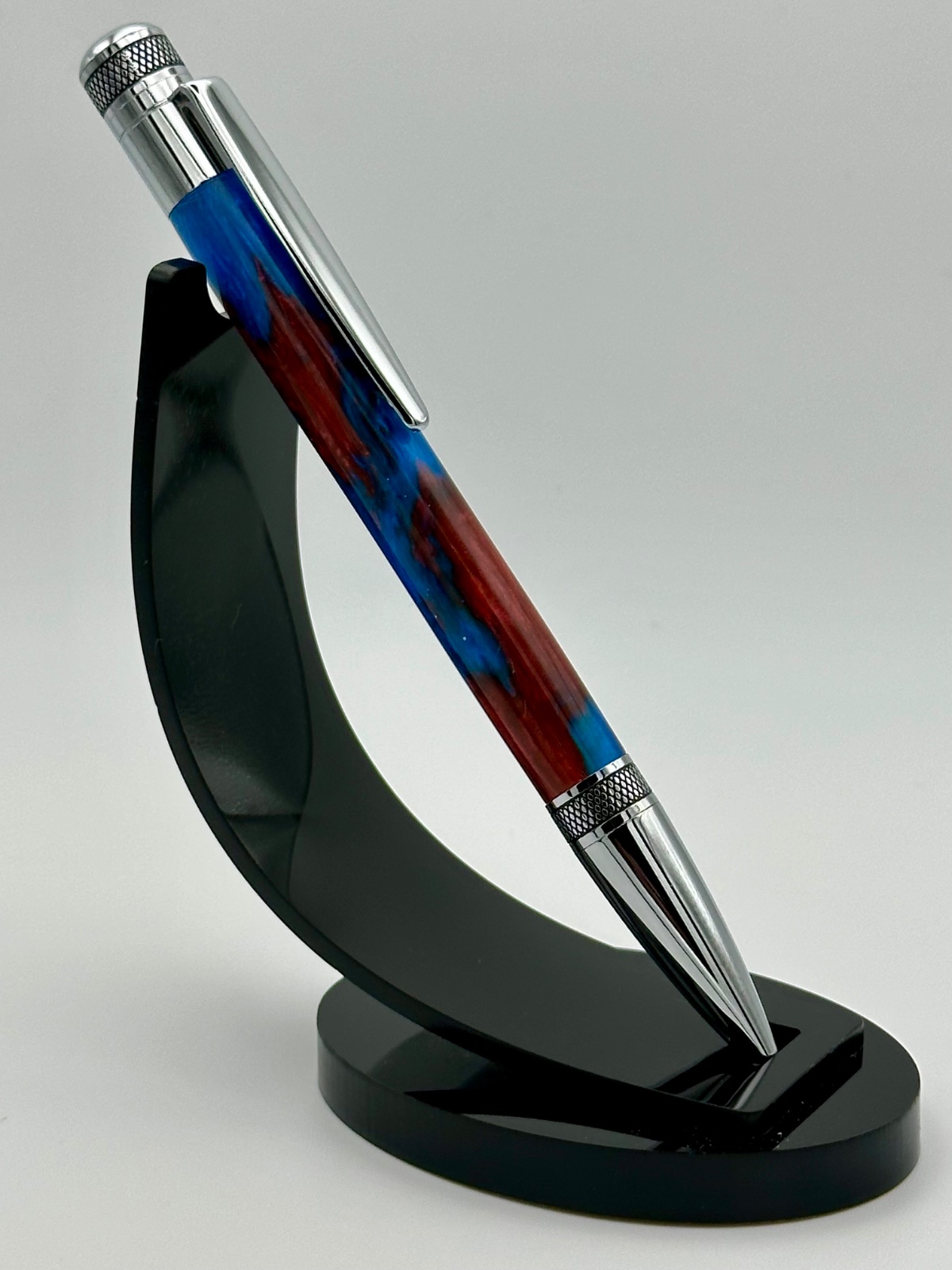

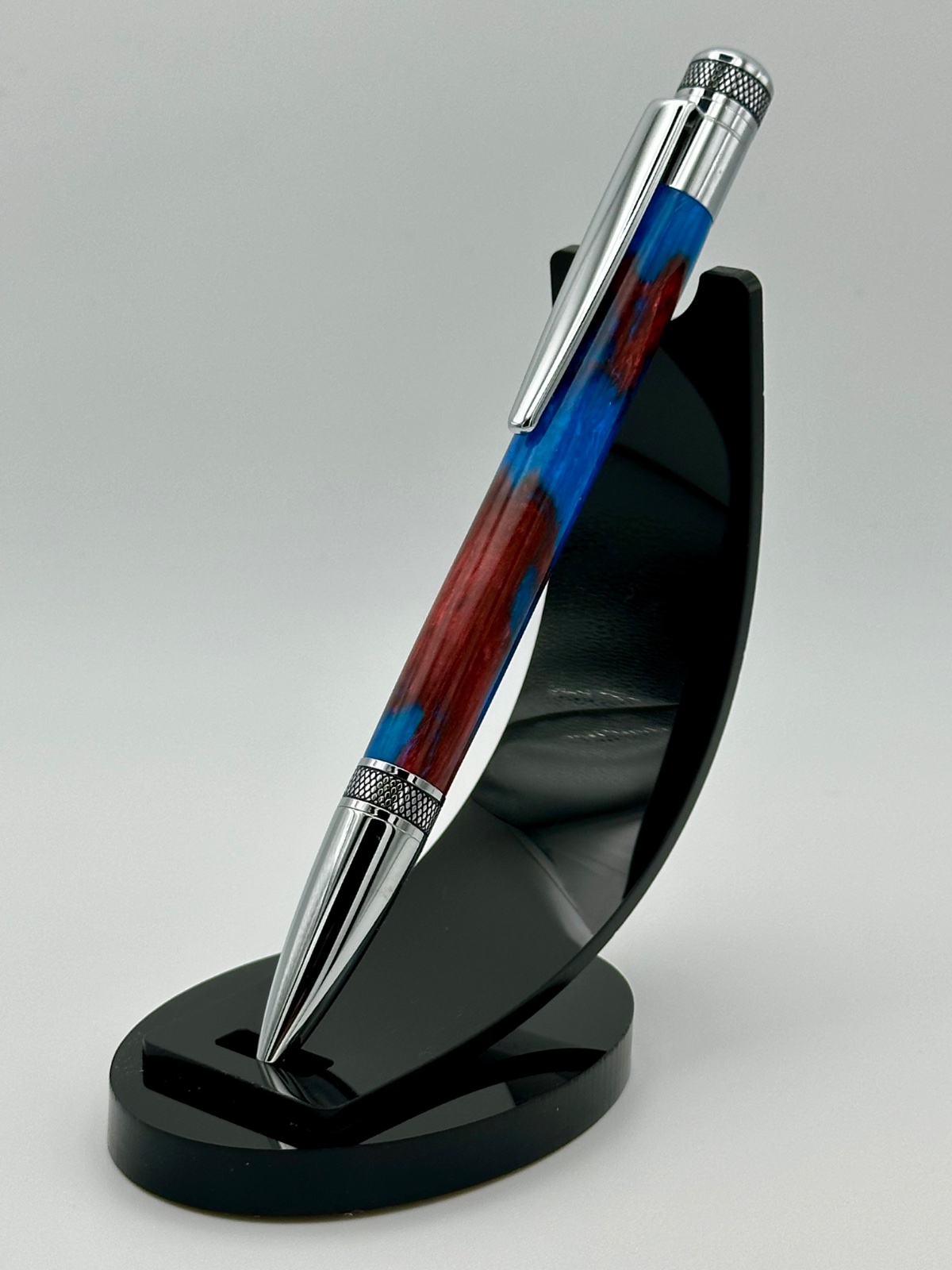

I posted the blanks I made in another thread and finally got around to turning one. A cortona twist from Penn State.
- Alumilite Clear Slow resin under pressure
- Turned with traditional tools (only a roughing gouge on this one)
- Dry sand from 120-600
- Wet sand with micromesh pads through all the grits
- Maguire's PlastX polish
- Renaissance Wax for the final
