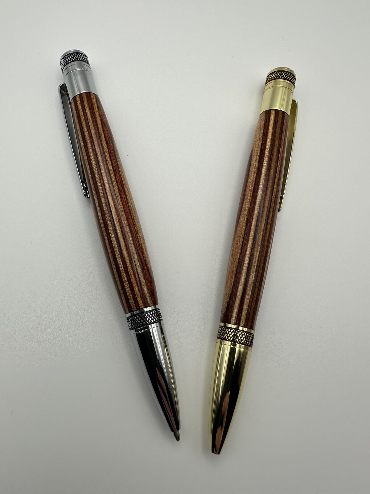

New kit to me. Lost 2 blanks barrel trimming. I need to invest in one of those squaring jugs for the sander.
They look great. That's a solid kit that doesn't distract from the blank, too. I do encourage you to get a squaring jig of some sort. Penmill type trimmers have ruined many a blank.

I hate that you lost some blanks to your pen mill, but a sanding jig is definitely the way to go. Your pens look great
