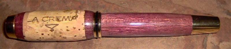

Cork pen made from 2 corks from local winery. Design was done with Magic Marker.
Several people have ask about the cork process. Before I started any drilling or cutting I glued two corks together, large end to large end. I then gave them many coats of super thin CA both ends and sides. Drilled the glued blank very slow. Knew I would be getting some blow-out on both ends so the blanks were longer than needed. Glued the tubes in and THEN cut them to size on band saw. Sharpened my SKEW very good and cut to size. The rest of application was standard. BEFORE I used the magic marker, I gave the cork blank another coating of CA as I found the ink runs a little.
Cork pen will look much better, if you will use more contrast cork (for example, from cork sanding block).
Also, there is too big step between cork and centerband.
And I don't like marker lines and spindle shape - but is is only my opinion.
I understand, I don't like the shape either, BUT was worried if the blank got too thin it would crack more. I wanted to use wine corks from the BV Coastal wines as that is what we were drinking at the time. All of their wine corks are the same. I wanted to retain their label bit it came off the first pass of the skew. Cork is plain that is why I used the magic marker. Anyway it was fun making and that is the game. Thanks for looking and your comments.

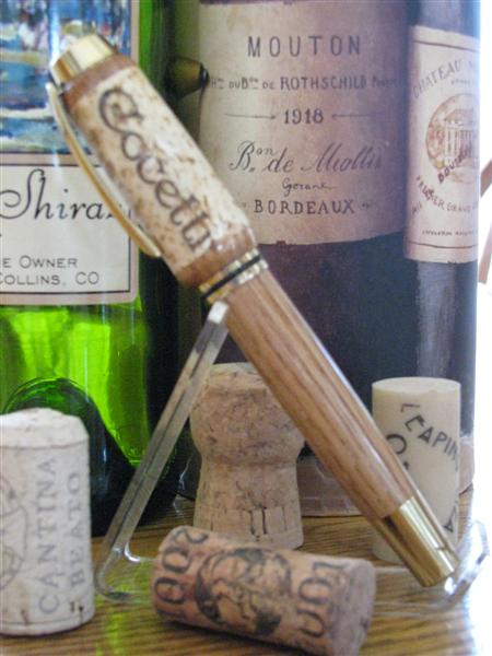

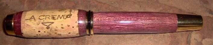

Nice. I, too, am curious to know your process if you would care to share? I tried to drill a cork a while back and it disintegrated in the drill press before I could even mount it on the lathe.
i can help you with that. I have made several wine cork pens.
Mr.Wright. You are on to something GREAT. Do not disturb the logos. Drill out the center and then size them to fit the tube.
John,
What is your process....how do you manage to drill and turn the cork?
It can be done just like any other blank, just take your time and make sure your tools are sharp. Turned/sanded just enough to get the parts to line up and finished with thin CA. These are on Gents with purple heart and oak from a wine barrel.
Brian
