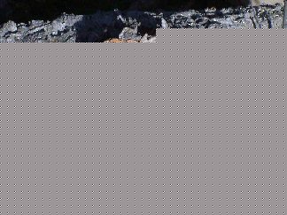

I was able to find this info about Cork Oak on the web . Hope it helps someone .
The cork-oak wood is an oak wood with a strong aesthetic character, with high density and mechanical resistance which may potentially be used for high value products, e.g. flooring, paneling or furniture, and substitute imported tropical species. Apart from the stem sanitary conditions and the resulting poor quality wood, other factors have jeopardized its use and the few cases of industrial processing: the complex anatomy of the wood and the lack of knowledge of its properties led to frequent cracking and collapse during drying, resulting in poor yields in sawn components and economic unfeasibility.
<br />
Tree with bark removed .
<br />
Cross section of a limb.
