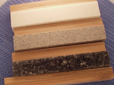

Here's some extra Corian I have, 1" square professional glue-ups... Some Alaskan Birch...

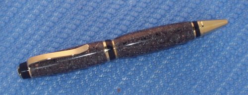

This is a Cigar kit with the 1" glue-up...
